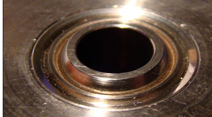

                                                     Correctly swaged V-groove bearing

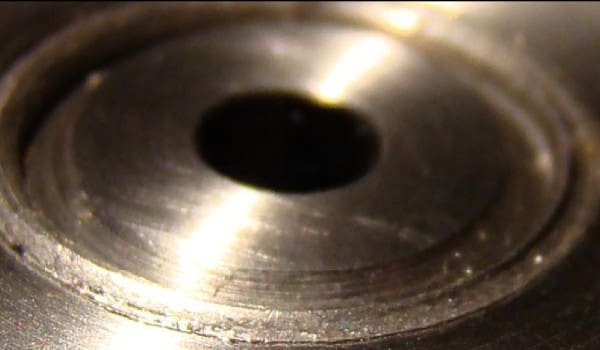

                                                      Poorly swaged V-groove bearing
The images above illustrate the different finishes provided by traditional anvil staking tools and Tri-roller swaging tools. The roll stake tri-roller tool (Fig 1) has provided an even, smooth and mirror-like surface to the swaging lip on the bearing. Virtually no gap is visible between the two components. This is in stark contrast to the solution provided by the anvil tool (Fig 2), where the surface is not as smooth as the tri-roller tool and an obvious gap between the swaged lip and the housing would suggest an inferior retention and mating between bearing and housing.
What is not obvious from the images but can result from using more basic tools are issues such as abrading, sheared edges, gauges and micro-cracks. These issues primarily arise because the forces used for anvil staking tools and the magnitude of material stress are much greater when compared to tri-roller swaging tools, which stress the material much less by causing the material to deform in small increments rather than forcing a large change in one movement.
The collective result of these factors is that by using a roll stake tri-roller swaging tool, the bearing is better seated in the housing, better able to perform its function and less likely to be damaged.

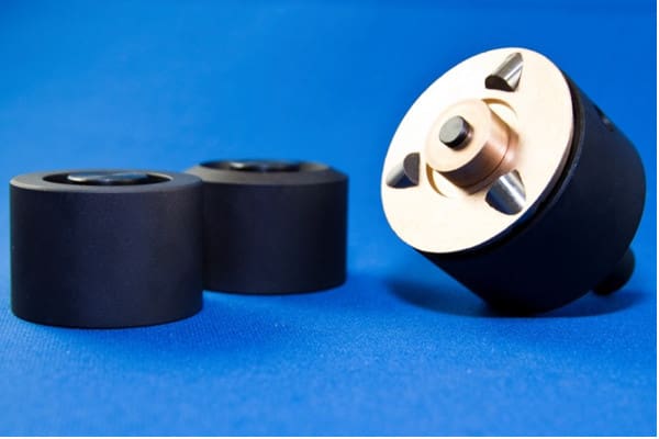

Tri-roller or roll stake swaging tools have been developed as an improvement to the traditional methods of Anvil or two-wheel swaging. These tools offer the advantage of allowing the three rolling elements in the tool to better contact the V-groove surface of the bearing at the correct angle, allowing the V-groove to fold over into the housing. Traditional two-roller and Anvil tools can cause damage to the V-groove lip. The Tri-roller tool uses a combination of downward pressure and roller rotation. The rollers push material from the bearing’s outer ring v-groove against the housing in order to locate it precisely and securely.
carter_3a_webcarter_3b_web
Roll stake or Tri-roller tools are typically available in either Drill-Press or portable style. Both these types of tools are normally supplied with both primary and secondary swage locating anvils.

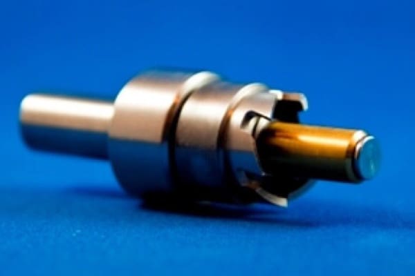

Cutter tools
Accurate removal of a bearing from its housing is just as important as correct installation. Cutter tools are specifically tailored to each bearing size in order to remove only the bearing itself with minimal or no damage to the housing.
carter_4a_web
carter_4b_web
V-groove bearing cutting tools, for example, should be designed to work by cutting down into the swaged V-groove of the bearing. This cut into the V-groove of the bearing weakens the bearing lip that was swaged against the housing so that it collapses easily into the bore when the bearing is pressed out. The cutting tools should be designed in such a way that the cutter only cuts the bearing and therefore preserves the integrity of the housing. Typically available as portable style or drill-press tools.

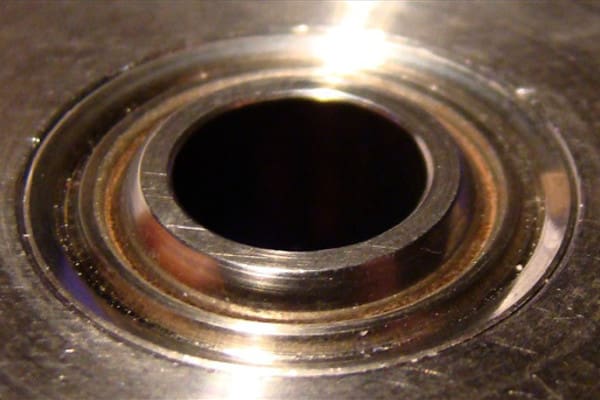

Installation & removal tools
Installation and removal tools are designed to insert and position a bearing accurately prior to swaging and to carefully remove the bearing once the swaged lip has been removed. The tool keeps the bearing perpendicular to the housing to ensure that the housing is not damaged during the installation or removal process. If bearings are just pressed into the housing, the sharp edges of the bearing could score the housing bore.
carter_5_web
If the housing fits are designed to be loose, an installation tool will not be needed. However, generally, removing a bearing will always require a tool, as the swaged lip will exert a good pressure against the housing even if it has been cut. Cutter tools are designed to allow the V-groove lip to collapse but the bearing still needs a force applied to it so that the bearing breaks free.
