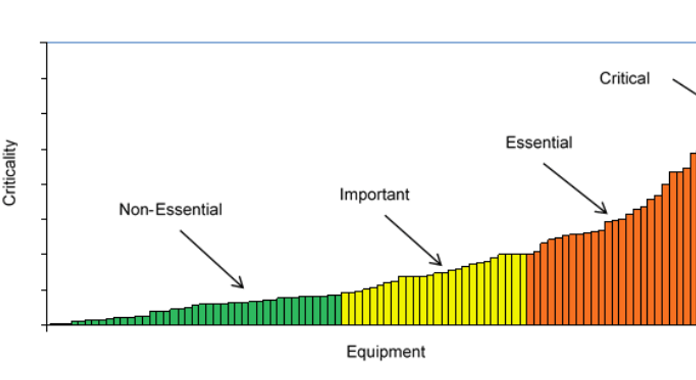

Criticality is a quantitative ranking process based on: operational cost, maintenance cost, throughput losses, quality, safety, and environmental implications. The graph below represents the criticality distribution of the equipment at a typical plant (Figure 1). Only 10% of the equipment at this plant is deemed critical due to the costs incurred if placed out of service. 25 percent can be defined as essential. 30 percent is important. The remaining 35% is non-essential. Each criticality level can be paired with an effective maintenance strategy to balance the cost of implementation with the required reliability levels.
