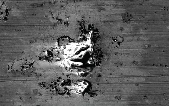

When a stray current in an electric motor uses a bearing as its path to ground, bearing damage can occur. The electrical current passing can cause micro cratering in the raceways of inner & outer rings and on the rolling element surface which ultimately changes the structure of the metal. Below is a picture of damage resulting from electrical discharges.
Once bearing damage from electrical corrosion has begun, increased noise levels, reduced effectiveness of lubricant and excessive vibration will drastically decrease bearing service life. In addition repair work this also incurs additional cost due to machine downtime and lost production. Current passage also has a negative influence on the lubricant
