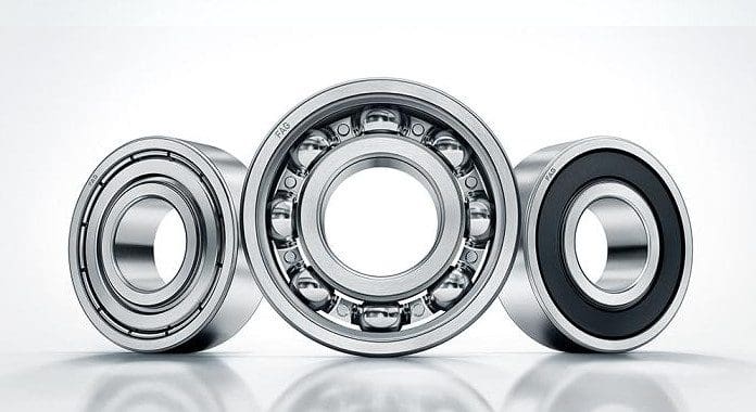

Various sealing concepts in the standard range for different requirements (from left to right): 1. Open bearing, 2. Gap seal on both sides (2Z), 3. lip seal on both sides (2HRS), 4. lip seal on both sides (2ELS), 5. non-contact seal on both sides (2BRS).
