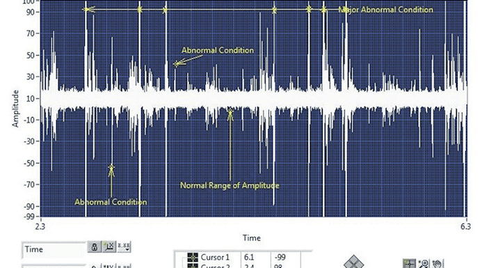

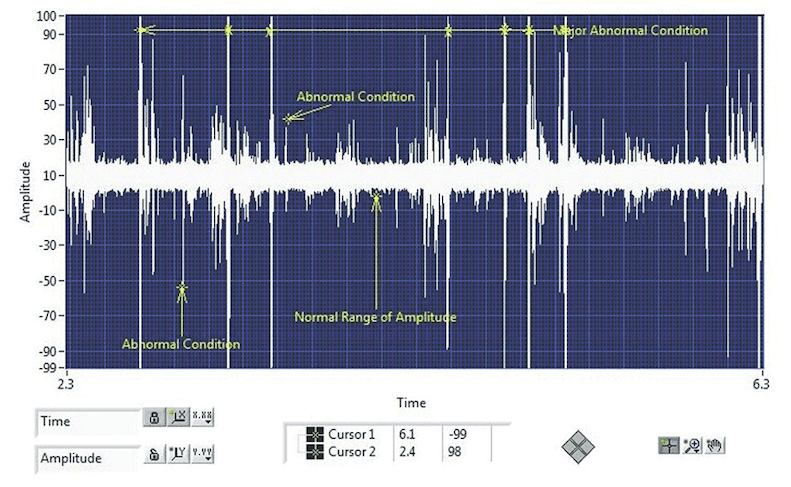

                                                       Sound Spectrum of a 1 RMP bearing
Here we can see the sound spectrum from a 1 rpm bearing on a furnace application. Note all of the anomalies that appear in the Time Wave Form from the “crackling and popping” sounds that were produced by bearing fatigue. This issue could only be properly diagnosed by using a sound spectrum analysis software.

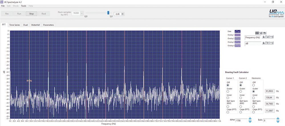

We can also use this type of software to identify where the fault is, if there is an integrated bearing fault calculator. By entering in the speed (rpm) and the number of balls (bearings), an outer race, inner race, ball pass, and cage frequency will be calculated.
                                                                 Use of a bearing fault calculator.
In this case, the speed was 1708rpm and the number of balls was 8. The fault frequency calculated by the spectrum analysis software that was of interest was an outer race fault at 91Hz.
