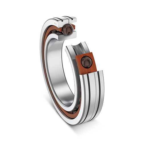

Bearings are central to the premise of using machine tools to produce precision-machined components. Key among the latest NSK products at AMB 2024 will be the ROBUSTDYNA angular contact ball bearing for machine tool spindles. This ultra-high speed, high-load capacity bearing delivers highly versatile machining via its outstanding performance during both roughing and finishing operations.
NSK’s ROBUSTDYNA angular contact ball bearings for machine tool spindles facilitate easier machining of challenging materials such as Inconel, titanium and composites
The use of larger balls in ROBUSTDYNA bearings elevates the maximum load capacity of this innovative product by up to 15% compared with the previous-generation solution. Users subsequently enjoy easier machining of challenging materials such as Inconel, titanium and composites. With up to three times more fatigue life (dynamic load rating), ROBUSTDYNA supports both heavy-duty and high-speed machining.
Another highlight on NSK’s AMB booth will be the SURSAVE (TSR) bearing cage for angular contact ball bearings, found typically on the main spindle of machine tools. The outer-ring-guided, PPS resin SURSAVE cage generates 20% less friction than conventional bearings. Machine shops can therefore tap into energy savings and greater workpiece precision due to less thermal expansion of the spindle.

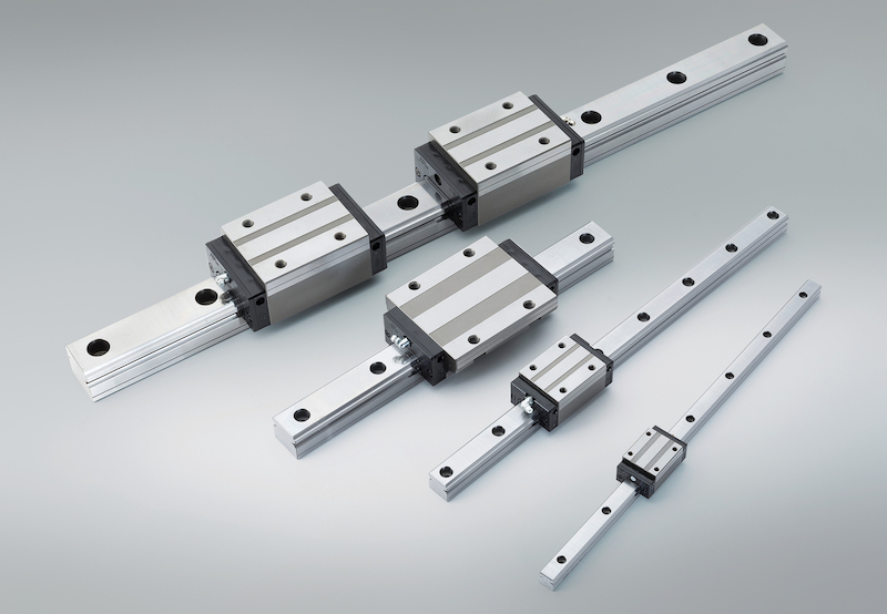

NSK DH/DS series linear guides provide over double the running distance of the company’s conventional NH/NS series

Other components central to the success of many new machine tools are linear guides. The centrepiece of the NSK offer at AMB will be the recently introduced DH/DS long-life series. With its class-leading dynamic load rating, the DH/DS linear guide provides over double the running distance of the company’s conventional NH/NS series. This advanced product also facilitates downsizing by allowing the use of smaller linear guides, reducing both machine weight and energy consumption.
