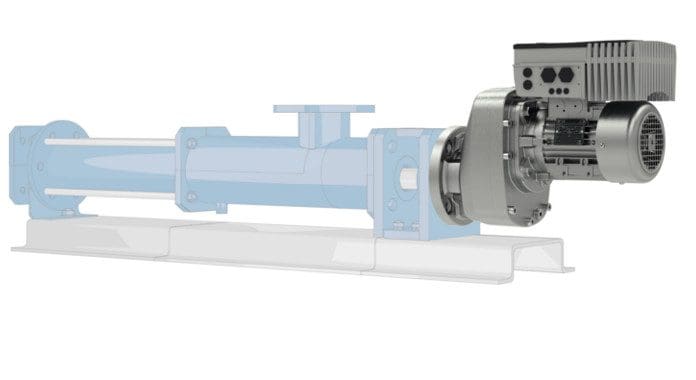

NORD DRIVESYSTEMS offers application-specific equipment options characterised by high performance and efficiency, specially designed for pumps, agitators, and mixers whose processes result in high radial and axial bearing loads. An agitator version (VL2 bearing) with increased bearing spacing and reinforced bearings as well as a Drywell version (VL3 bearing) with additional oil drip plate and leakage or oil sensor are also available. The bearing spacing of the VL2 and VL3 versions is increased with attachments while the gear unit size remains unchanged. NORD also offers bearings that were intentionally oversized to meet the requirements of applications such as pumps or agitators.
For pump applications, NORD DRIVESYSTEMS offers highly reliable drive solutions with wide speed ranges and a high radial and axial load capacity
Chemical, pharmaceutical, food or water treatment sector – the robust drive solutions by NORD DRIVESYSTEMS offer top reliability and ensure unobstructed operation. Reinforced and larger output shaft bearings allow the gear unit to absorb the high axial and radial forces and thus prolong the service life.
