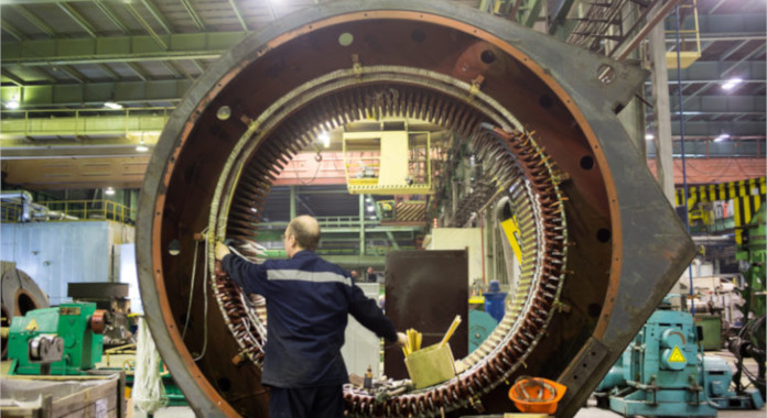

Q2. I know that larger motors on drives are subject to high frequency circulating currents.  Do they still have problems with shaft voltage discharge (EDM) current?
A2.  The short answer is Yes.  When a three phase motor is on a drive, the voltage in the three phases will never cancel out.  There will always be some extra voltage in the motor windings.  And that extra (“common mode”) voltage is always going to charge up the rotor and create a shaft voltage.  Now, we say “shaft voltage,” but the real problem is that you have a voltage across the bearings.  And if the shaft voltage is bigger than a few volts, it’s going to arc through the bearings and damage them.
It’s true that circulating currents are actually a bigger problem than shaft voltage in these large motors.  You can interrupt (stop) circulating currents with one insulated bearing.  Protecting one bearing from circulating current protects the other too.  But insulating one bearing won’t protect the other bearing from EDM bearing current from shaft voltage discharge.  So to minimize the risk of electrical bearing damage in these motors, you need one insulated bearing and good reliable shaft grounding like an AEGIS ring.  (And grounding of the motor frame to prevent rotor ground current, but that’s another issue.)
