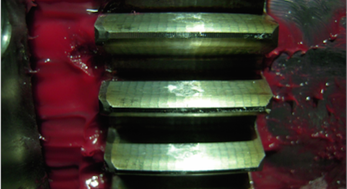

Q:  If you have insulated bearings, do you still need AEGIS?
Example:  One company had a 600 hp motor in a paper plant.  They had a lot of bearing failure, so they put in two insulated bearings.  Then the motor was fine.  BUT the shaft voltage was still there, and ended up discharging through & damaging the gearbox!  So they protected their $50k motor but had to repair their $250k gearbox.  That was even more expensive to repair than the motor was.A:  We recommend it.  In high-capacity/high-value and critical applications, you often have two insulated bearings on motors.  But with insulated bearings, shaft voltage is still there.  It can discharge through coupled equipment.
A gear in a gearbox damaged by shaft voltage discharge
