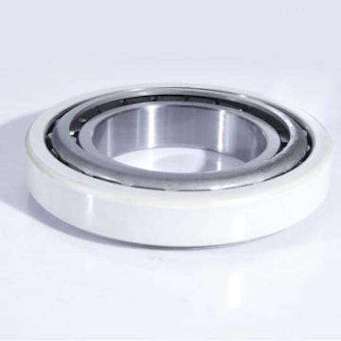

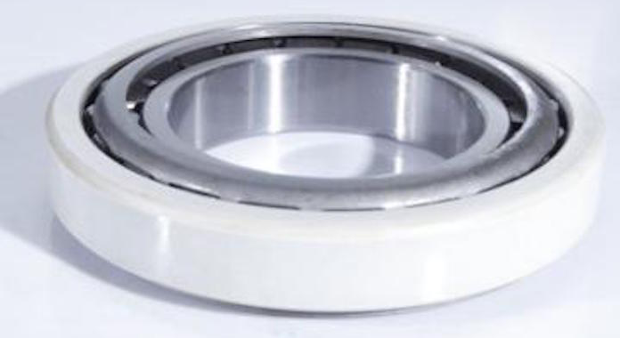

A: First off, there are two levels of insulated bearings.
“Insulated bearings” per se have an aluminum oxide coating on the outer or inner ring – for example, SKF’s INSOCOAT bearings. The rolling elements are steel. Their cost is about 3-5 times a standard bearing. The electrical resistance of the aluminum oxide coating is high, from 5 to 150 MΩ (megaohms). But it is still possible to get shaft voltage building up enough to cause arcing through the steel parts of the bearing.
There are also hybrid or ceramic rolling element bearings. These have steel rings and ceramic balls (rolling elements), and are essentially electrically inert (~ millions of MΩ). If you put two ceramic bearings on the motor, then current cannot pass through the bearings, period. One downside is that ceramic bearings and couplings are 7-10 times more expensive than standard bearings.
Back to the question, if it can’t get through the motor bearings, then how can the shaft voltage discharge? If the motor is coupled to a fan or a pump, the path of least resistance to that current from the shaft will be through the equipment. So the motor bearings will be fine, but the bearings of the coupled equipment will be damaged.
If your primary concern is the coupled equipment – your fans, gearboxes, and pumps – they’re typically 2-3 times more expensive than the motor driving them. If you electrically isolate the motor shaft from the frame, with insulated bearings, the shaft voltage from the VFD will still seek a path to ground, and that path is probably going to go through that expensive coupled equipment. Insulated bearings protect the less-expensive part of the system and leave the more expensive parts vulnerable.
This can be prevented with an electrically insulating ceramic coupling between the motor shaft and the driven equipment. But like ceramic bearings, ceramic couplings are expensive, again 7-10 times the cost of an ordinary steel coupling.
It is more economical to protect small motors and their driven equipment with an AEGIS® Shaft Grounding Ring. By bleeding voltage off the shaft, the ring protects both motor and equipment bearings. Motors over 100 hp (75 kW) are prone to high frequency circulating currents, as well as shaft voltage discharge damage. For these larger motors, we recommend one bearing with outer ring insulation to interrrupt the circulating current, along with an AEGIS ring to take care of the shaft voltage.
So insulated bearings are limited, but they’re definitely better than nothing at all. We recommend one of them, in conjunction with a grounding ring, because they’re much less expensive, but still protect adequately against circulating currents.
