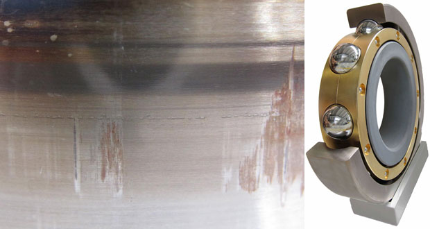

NKE Bild 3 SQ77E_sl1
NKE SQ77E deep groove ball bearing with insulation on the inner ring.

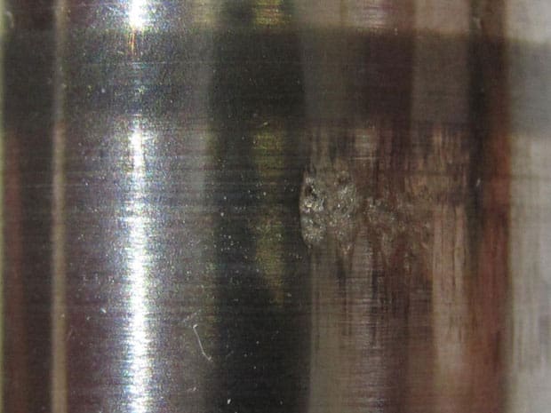

NKE-Bild-1a-Stromdurchgang-WK-CRB
Fig. 1a
NKE Bild 1b Stromdurchgang IR CRB_sl2
Fig. 1b
Current passage has led to a formation of craters/flutes on the inner ring raceway (Fig. 1a) and the lateral surface of the rolling elements (Fig. 1b) of a cylindrical roller bearing.
The main reasons for current discharge are known. Asymmetries in the magnetic flux of an electrical machine give rise to a low-frequency voltage between the shaft and the housing, which results in a flow of current through the rolling bearings. Such a passage of current can also result from the use of unshielded asymmetrical electric cables if the earth connection of the machine is ineffective. Another cause is the use of frequency converters: The operating principle of many frequency converters is based on pulse width modulation (PWM) and generates high-frequency common mode voltage, which also results in a passage of current through the rolling bearings. Lastly, electrostatic charging of the shaft and housing followed by discharge through the rolling bearings is also a possible cause.
Damage symptoms and possible countermeasures
Typical signs of electrical corrosion include grey, tarnished tracks in the raceways and on the rolling element surfaces. Melt craters (Figs. 1a and 1b) or fluting is also discernible, mainly on the raceway surfaces. Damage due to current discharge usually manifests itself in increased running noise.

For electrically insulated bearings from NKE, the insulating layer is applied to the outer ring (SQ77 or SQ77C – Fig. 2a) or the inner ring (SQ77E or SQ77H – Fig. 2b) by plasma- spraying, a thin-film technology. During plasma- spraying, an electric arc is created between two electrodes with a suitable gas supply. The plasma jet serves as a carrier medium for applying the aluminium oxide powder (Al2O3) either to the outer or inner ring at high velocity. In order to obtain optimum protection the oxide layer also covers the side faces of the sprayed rings. In the next process step, the layer is then sealed to prevent any penetration by moisture.
NKE Bild 2a und 2b
Fig. 2a                                                                         Fig. 2b
Figs. 2a and 2b: For electrically insulated bearings from NKE, the insulating layer is applied to the outer ring (SQ77 or SQ77C – Fig. 2a) or the inner ring (SQ77E or SQ77H – Fig. 2b) by plasma-spraying, a thin-film technology.
