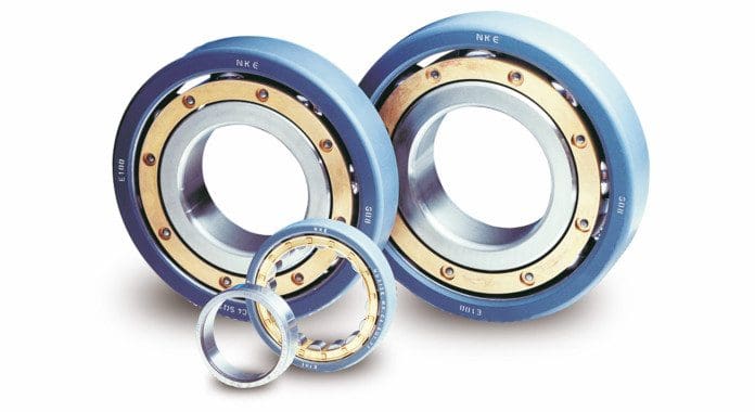

Figs. 2a and 2b: For electrically insulated bearings from NKE, the insulating layer is applied to the outer ring (SQ77 or SQ77C – Fig. 2a) or the inner ring (SQ77E or SQ77H – Fig. 2b) by plasma-spraying, a thin-film technology

For electrically insulated bearings from NKE, the insulating layer is applied to the outer ring (SQ77 or SQ77C – Fig. 2a) or the inner ring (SQ77E or SQ77H – Fig. 2b) by plasma- spraying, a thin-film technology. During plasma- spraying, an electric arc is created between two electrodes with a suitable gas supply. The plasma jet serves as a carrier medium for applying the aluminium oxide powder (Al 2 O 3 ) either to the outer or inner ring at high velocity. In order to obtain optimum protection the oxide layer also covers the side faces of the sprayed rings. In the next process step, the layer is then sealed to prevent any penetration by moisture.
NKE SQ77E deep groove ball bearing with insulation on the inner ring
