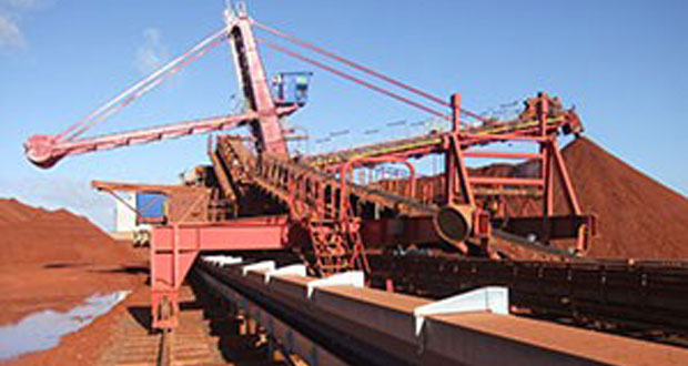

The paddle-wheel stockpiling unit at the AOS open-air storage facility reaches impressive dimensions. As part of a general overhaul its energy supply system was modernised.

The Aluminium Oxid Stade GmbH (AOS) is one of the major alumina producers in Germany. It processes the raw material bauxite into alumina of high purity which is then sent to the processor. More than one million tonnes of alumina are produced every year in Stade. For this, one needs about double the amount of bauxite, which the deep-sea vessels bring from Africa, Australia, and South America and deliver at the AOS’ own harbour. A single ship delivers up to 70,000 tonnes of raw material that is transported further via an enclosed conveyor belt system for temporary storage. The different types of bauxite are either stored in warehouses or large open spaces and fed by an impressive, highly visible paddle-wheel stockpiling unit of the production (Figure 1).

As a complete overhaul of the stockpiling unit was being undertaken, those responsible decided not only to modernise the unit itself, but also to renew the rail track and the energy supply of the conveyor system. Originally the conveyor was supplied with energy and signals over its at least 366 long track via a motor cable drum. Now a modern energy chain system from igus® undertakes this task (Figure 2). Since the push/pull forces that occur across the length of the travel shouldn’t be underestimated, the project engineers recommended the use of a roller e-chain® that doesn’t glide in the guide trough, but rolls via highly stable rollers with stainless steel ball bearings. Since the environmental conditions are unfavourable (outdoor use, temperature changes, humidity, dust), there is a “heavy duty” roller chain of type 5050RHD for application. Outer radius stops prevent the conveyed material from sticking (Figure 3). In addition, the guide trough is equipped with an enclosure as a protection against ascent and weather.
The design as roller chain minimises the occurring push/pull forces, and the outer radius stops prevent the conveyed goods sticking to the moving parts.
