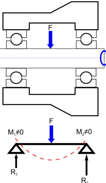

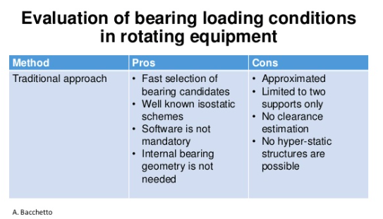

The traditional approach
The traditional approach allows to estimate the bearing load in applications based on a single shaft supported by one or two bearings, by means of isostatic models of simply supported beams.
This method is ideal for a quick bearing selection: with the minimum of information on shaft geometry and operating conditions, the bearing load can be assessed for a wide range of applications.
In the example shown in the picture, the traditional method can quickly provide how much of the applied load (F) is carried by each support.
However, hyper-static structures (shaft supported by more than two bearings) cannot be easily handled and more sophisticated models are needed to evaluate the distribution of the applied force into the different supports.
Additionally, one of the main assumption is that the bearings are infinitely rigid in relation to the radial displacements and that they do not offer resistance to the rotations.
Furthermore, since the internal geometry of the bearing is not required, the loaded rolling elements are assumed to be covering a load zone of ~180 degrees without any further detail calculation.

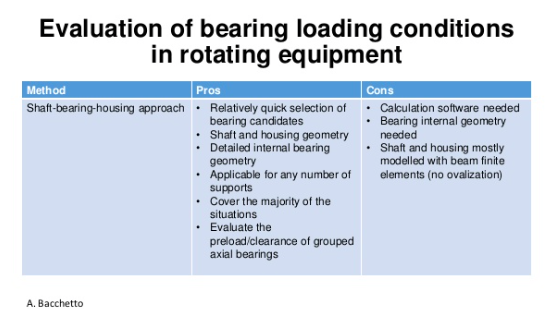

The shaft-bearing-housing approach
The assumptions introduced by the traditional approach on the bearing stiffness (= resistance to displacements and rotations) are not always close to reality. In fact, each bearing type behaves differently: not all the bearing types are suitable for large rotation and/or large axial excursions; some other types are designed to withstand those kind of deformations. However, in order to better understand the bearing behavior, it is important to know their internal geometry. Additionally, the bearing stiffness also depends on it: it is remarkable to observe that a difference of a few micrometers in internal clearance can result into a substantially different behavior in relation to displacement and rotations.
The bearing stiffness is one of the fundamental “piece of the puzzle” that is taken into account in the shaft-bearing-housing approach. The final equilibrium depends on several combined stiffness contributions: shaft, housing and bearings. Since every micrometer counts, the accurate evaluation of the bearing behavior, depends on also on the real operating conditions, especially rotational speed and temperatures. Additionally, the fits used to fix the bearing onto the shaft and inside the housing seats are also an extremely important element to consider. In fact, fits, rotational speed and temperatures are heavily changing of the initial bearing manufacturing clearance into the operating one (see also clearance reduction).
Moreover, as shown in the picture, by considering the real internal geometry of the bearings as well as the shaft and housing geometries and mounting fits, the solution of such system is not the one that the traditional method would suggest:
- The right bearing may fill a stronger clearance reduction due to different housing geometry and possibly fits
- The right and the left bearings may present different stiffness due to a difference in operating internal clearance
- The bearings are developing bending moments due to the finite rotation stiffness offered by the ball bearing
- Because of the different internal clearance, the bearing loading conditions may not be the same even though the load is positioned in the middle of the shaft.
Additionally, for axial bearings, such as tapered roller bearings and angular ball bearings, there is the need to accurately assess the right amount of preload/clearance used in each group: the optimum value will ensure the maximum life in the given operating conditions (see more at this page). The corresponding amount of microns necessary to reach this optimum condition is one of the most difficult operation to measure on the shop floor. In this case numerical simulations are a great help to quickly tackle the preloading operation.

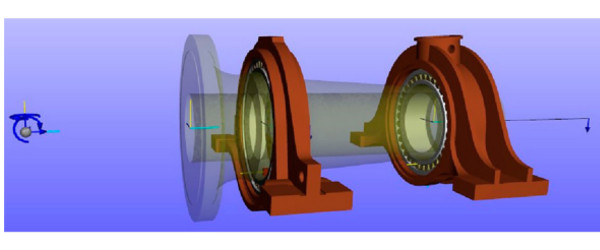

The system approach
As discovered above, considering bearings inside a flexible housing rather than rigidly fixed to the foundation, provides different results: the bearing behavior is impacted by the mutual interaction with what is connected to it. Moreover, in many applications housings may present shapes that are not easily represented by simple pipes. A housing with a lot of stiffening ribs may influence the bearing behavior and hence its internal loading conditions among the rolling elements. In these cases, complex housing geometry introduce a non uniformly distributed stiffness forcing the bearing to react differently along the circumference; again, the internal load distribution among the rolling elements may deviate from the expected pattern of the typical load zone.
In case the housing 3D geometry is available, the stiffness of such components may be calculated to correctly evaluate by means of advanced numerical methods. In this way it is possible to better capture how the bearing seats may move in the space and how they deform under load. In fact, one of the powerful possibility of the system approach is the evaluation of the ovalization of both bearing rings and bearing seats. In general, with an increased level of flexibility, the load zone also increases with a correlated decreasing in the rolling element load. With a lower level of contact load on the raceway the bearing performance evaluation will automatically increase.

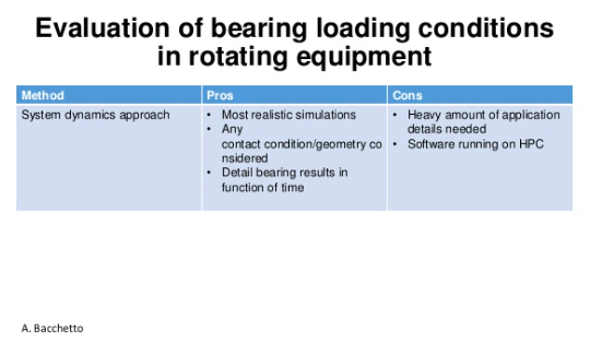

The system dynamics approach
The above methods are uniquely static or quasi-static: time variation is not taken into account and inertia is not playing a role in the equilibrium of the forces acting on the system. However, the rotational speed may be taken into account to evaluate the extra centrifugal forces acting on the rotating parts.
In reality, the operating conditions are reached after the start-up phase: in such phase the amplitude of the applied forces varies in time before reaching a stable plateau.
In order to be able to simulate this start-up phase, transient analyses are needed to solve the equation of motion: in the full version of the force equilibrium the inertia effects due to the system mass (m) becomes an important element to be considered.
These kind of analyses are also used where the applied loads evolve in time: e.g. impact, high speed, rotordynamics applications, etc. In these advanced simulations, all the components of a bearing (rolling elements, rings, cage, etc.) move within certain constraints modeled by means of contact elements. As forces vary in time, displacements also vary in time and the contact elements need to be able to deal with contact conditions varying in time.
It has to be pointed out that, in order to evaluate an accurate dynamic bearing behavior, a lot of information are needed, e.g. internal geometry of rolling elements, cage geometry, raceways profiles, temperature dependent material properties and models, etc. In order to deal with all this input and to properly solve the complex numerical schemes, a highly sophisticated software is needed able to run on powerful computers, such as High Performance Cluster (HPC).
