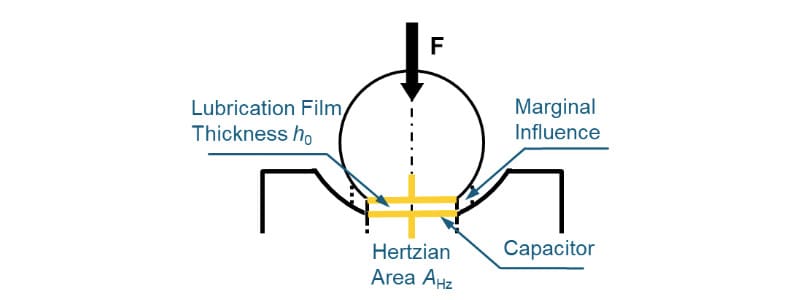

The current trend in process monitoring and predictive maintenance propels the development of sensor-rich systems. Against this background, the authors investigate using bearings’ electric properties as a sensor. This approach is based on electric impedance of bearings under an EHD regime, which depends on bearing load, speed and temperature. In an EHD regime, a non-conductive lubricant separates the surfaces of the rolling elements and the bearing rings. The electric model for every rolling contact is a plate capacitor, with the plates formed by the Hertzian area and the lubrication film thickness being the plate distance, as shown in Figure 1. In addition, the marginal area around the Hertzian area influences the electric impedance. Figure 2 shows a schematic design of such a sensor bearing. The lubrication film thickness depends on the temperature and rotational speed of the bearing [1]. Therefore, speed and temperature sensors are integrated into the sensory bearing. The electric measurement circuit needs to be isolated from the metal structure of the machine; the necessary isolating layers are shown by red lines in Figure 2. Finally, the electric impedance, temperature and rotation speed data are processed into information about bearing loads, lubrication condition and possibly bearing condition.
