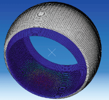

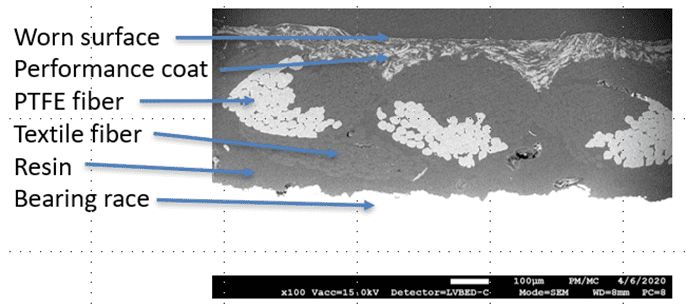

Realizing there was a specific market requirement for the Type A (100k+ cycles) qualification under AS81820, we set forth a challenge to develop the FenlonTM Asta to meet and surpass this challenge. As a Michelin Group Company, we were able to assemble a team of experienced and educated experts in the fields of Tribology, Finite Element Analysis and Material classifications to enhance our project success. Fenner was committed to finding a better way to meet this customer need. That meant the company not only had to develop and introduce a new high-performance liner that would meet the standard, but it also needed to create a laboratory test method that would replicate real performance for Fenlon customers. This method had to accurately predict wear profiles, coefficient of friction, and load capacity for each unique application. Fenlon Asta was three years well spent!

Bearings are critical components in many aeronautics’ applications, from landing gear and wheels to wings and other structural elements. One of the most vulnerable points in a
bearing’s structure is the location where the bearing’s ball and race (or outer ring) come in contact. In the past, these surfaces, generally steel, were lubricated with greases and oils, which require frequent change-outs and replacement. Bearing manufacturers have now turned to low-friction, solid-lubricant fabric liners made of polytetrafluoroethylene (PTFE) that meet or surpass the performance of their liquid predecessors, without the constant maintenance and environmental impact of oils and greases.

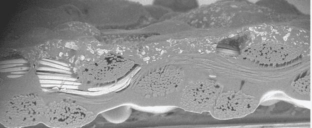

Of course our formulations and material science is proprietary…but I can expand on the Fenner advantage…It takes advanced material science not just to customize and manufacture state-of-the-art self-lubricating fabrics, but to specify, design, and fabricate them. We at Fenner Precison Polymers have advanced applications engineering expertise, including needs assessment and product design and development of finished materials. We have industry-leading manufacturing capabilities in weaving, warping, and coating fabrics and we have the widest range of yarns, fabrics, and resins, including PTFE, polyester, aramids, and fiberglass. We have state-of-the-art testing capabilities to ensure the finished materials meet your specifications. From resin development to lab testing and FEA testing to customer testing, the Fenlon Asta formulation consistently outperformed the other new formulations that Fenner considered addressing the most common complaint from customers working to achieve Type A qualification. The team, as a result, met its goal of introducing a new bearing liner, Fenlon Asta, and developing a testing process that allowed Fenner to predict whether a specific liner would support a bearing manufacturer’s goal of meeting AS81820 Type A requirements.
