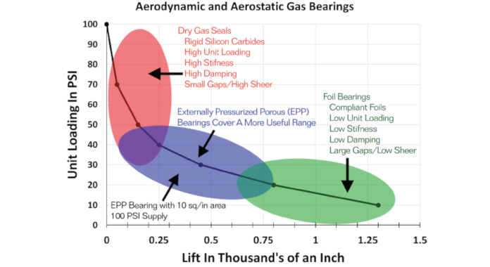

It is hard for some to imagine how an air film could be too stiff in a structural loop made of metal but this can easily be the case. Stiffness of externally pressurized gas bearings, as we have seen, is a function of film thickness, which is a result of the input pressure and load conditions. A gas bearing with 0.5 square foot (6 x 12 inches of face area), fed 60psi compressed air and loaded with 2,500lbs will have a film thickness of .0002 inches and almost 10 million lb./in stiffness with flow less than 1 SCFM. The same bearing with the same input pressure but with just 10% the load (250lbs), would have higher flow and stiffness less than 1000 lb./in. This is a change of four orders of magnitude in the stiffness for a one order change in the load. This effect can also be seen in the lift load plot in Figure 4. At large gaps, above 0.0005in, the curve is near horizontal, which would be zero stiffness; at small gaps the curve is near vertical, which would be infinite stiffness.
—Figure 4 This is a “big picture” chart to conceptualize gas-bearing technology in turbo equipment. It is a lift vs. load chart for an externally pressurized porous (EPP) gas bearing that has 10 square inches of bearing face; 100 psi is fed to the bearing as the load on the bearing is increased. Resulting air gaps are shown on the bottom axis. The slope of the curve is representative of the film stiffness. The typical operating regions of dry gas seals and foil bearings are super imposed, as is the operating area for EPP Bearings. It can be seen that the EPP Bearings operate with a larger gap than dry gas seals, reducing heating and contact issues but still having good stiffness, damping and speed capabilities.
