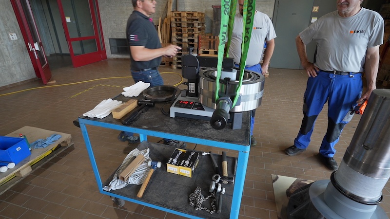

For the installation of the new spherical roller bearing (SKF 24148 CC/W33, 79.2 kg), simatec relied on its proven technologies:

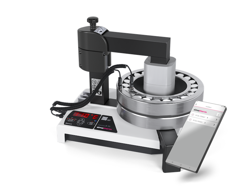

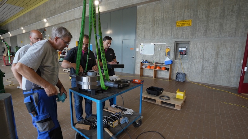

simatherm IH 125 – Precise Induction Heating
Using the IH 125, the bearing was heated uniformly to 140 °C. The multi-step induction process allowed for a stress-free and exact fit on the shaft — no force, no guesswork.

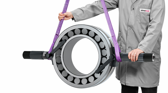

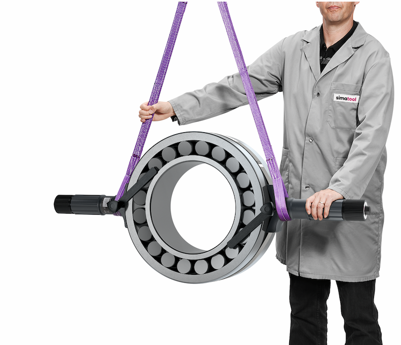

simatool BHT – Safe Handling of Heavy Bearings
With the simatool Bearing Handling Tool, the large bearing was moved and positioned securely. The customer was impressed — both with the tool’s performance and the on-site training provided by simatec staff.
World of Maintenance App – Full Digital Control
The heating process was monitored and controlled via the World of Maintenance App. The technician managed the entire operation through their smartphone — efficient, mobile, and fully documented.
Hands-On Collaboration: When Technology Meets Practice
A highlight of the day was the on-site training during the installation. The customer was actively involved — experiencing first-hand how easy, safe, and fast a bearing can be installed using the right tools. Close coordination with the simatec team ensured a smooth process and maximum learning effect.

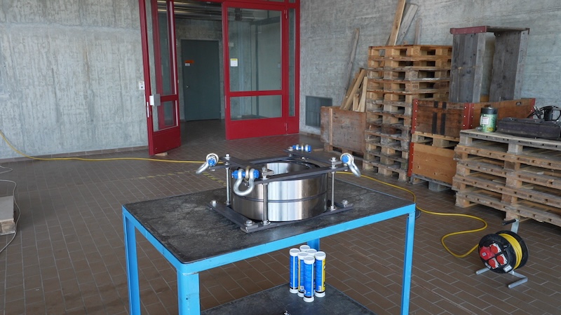

Custom design by the customer – Individually crafted lifting and mounting aid:
This manually crafted tool was developed by the customer with significant time investment specifically for the bearing size described. While the construction serves its purpose, it is severely limited in terms of functionality, safety, and versatility – and can only be used for this specific application.
simatool Bearing Handling Tool (BHT) – Professional handling tool for large bearings:
The simatool BHT was developed by experts to mount and transport rolling bearings safely, efficiently, and with minimal material stress. It is designed for a wide range of bearing sizes and types, TÜV-certified, and ready for immediate use – a well-engineered solution from professionals for professionals.
