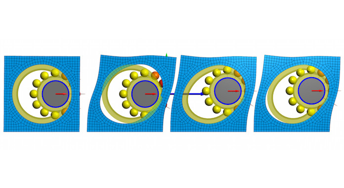

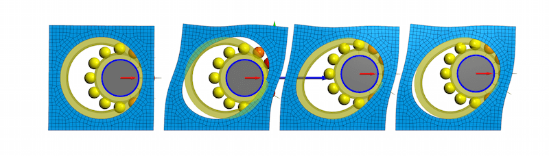

The interface between bearing and shaft/housing can be modelled in different ways. The software provides five options to model this interface. Connection by a single node with rigid or elastic condensation, reduction to multiple nodes with or without adding the bearing ring stiffness and optionally contact between bearing ring and shaft/housing.
Image 1: Deformations for different modelling of interface between bearing and housing
Image 1 shows a single bearing loaded horizontally and without clearance in an elastic block which is clamped rigidly at the bottom for four cases. The left two cases are using a static reduction of the housing to a single node. The reduction is done by a rigid constraint in the first case and by averaging displacements in the second case. Using a rigid constraint is stiffening the housing, leading to much smaller deformations. Using a single node for the reduction of the housing bore leads to bearing forces acting on the whole cylindrical surface of the bore, which does not correspond to reality as the bearing forces are transmitted by pressure and not by tension. But this is acceptable in many cases.
The third case is using an elastic bearing ring glued to the housing, so no nonlinear contact between ring and housing is considered. Compared to the second case the horizontal deformation is quite similar, but a vertical displacement is added due to consideration of the deformations of the ring. The right case is considering contact between the bearing ring and the housing which leads to slightly increased deformations in horizontal and vertical direction. In the cases using an elastic ring forces to the housing are only applied in the load zone of the bearing.

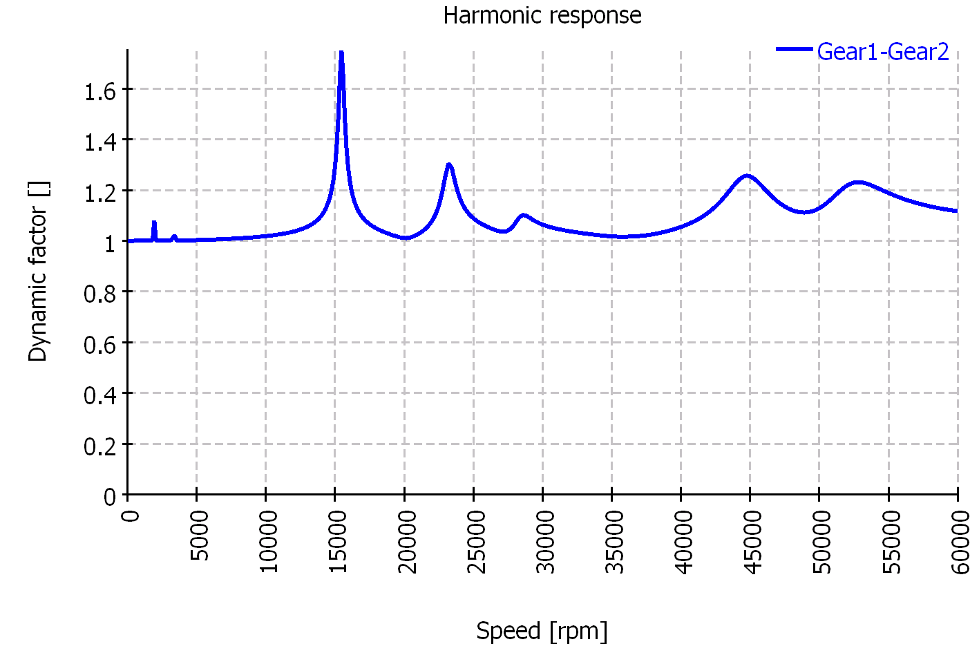

Harmonic excitations defined as displacements
Previously harmonic excitations could be defined as forces in the shaft calculation. Now harmonic excitations can also be defined as displacements. Examples could be roundness deviations of bearings and gears or transmission errors of gears or vibrations of foundations.
Evaluation could be done as dynamic factor over speed for gear pairs for example. The peaks show possible resonances, but for the amplitude the influence of damping is a problem as there are restricted possibilities to define damping and usually there is only little knowledge about damping too. Like the variation of gear forces also amplitudes for bearing forces can be shown.
