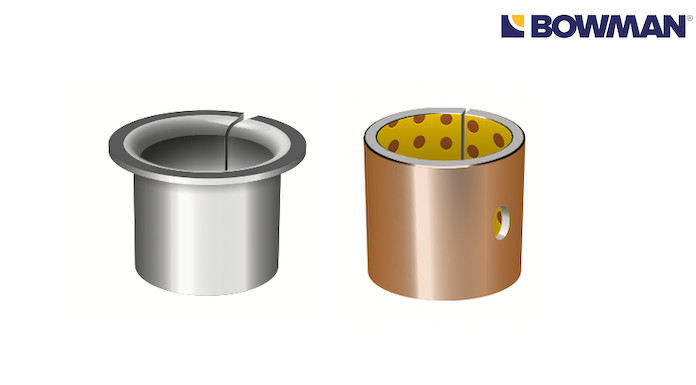

PTFE LINED WRAPPED BEARINGS
Bowman WMU range of PTFE lined wrapped bearings is suitable for dry running, low friction, low wear applications. These wrapped bearings have excellent sliding characteristics forming a transfer film that can protect the mating metal surface.
Our PTFE lined wrapped bearings have been developed for high duty applications. Such applications include, but are not limited to:
• Automotive suspension struts
• Shock absorbers
• Hydraulic cylinders
• Gear pumps and motors
• Axial and radial piston pumps and motors
• Many other applications
Bowman is able to offer PTFE lined wrapped bearings in metric plain, imperial plain, metric flanged, metric washers, imperial washers, metric strip and imperial strip. Special sizes can be produced to customer requirements. Equivalent alternative brands include: Glacier Garlock DU, P10, P14.

WRAPPED ACETAL LINED BEARINGS
Bowman WMX range of wrapped acetal lined bearings is suitable for rotary and oscillating movement applications. They benefit from long re-lubrication intervals, no absorption of water, outstanding damping behaviours and have a low susceptibility to edge loading.
The WMX range is ideal for the automotive, machine building and agricultural industries and indeed any application where lubricant cannot be supplied continuously.
