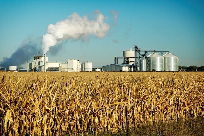

In early 2017, at Red Trail Energy’s ethanol plant in North Dakota, several large motors’ ball bearings were failing much sooner than they should.  Replacing motor bearings isn’t cheap.  But for a production plant, the actual cost of repair is a drop in the bottle.  What really hurts is the downtime from repair causing lost production.  And lost revenue.
The plant manager soon had enough of these frequent interruptions, and called in a grounding system specialist to troubleshoot the three problem motors.
