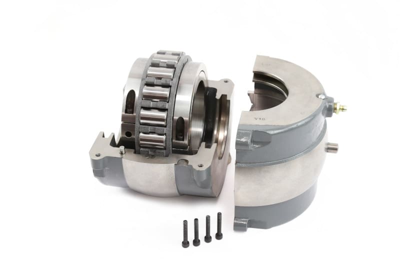

Global bearings innovator, Bowman International, has launched to market a split roller bearing with substantially higher radial and axial load capacities.
Ideal for applications such as propulsion shafts in ships, screw conveyors in abrasive industrial environments and conveyor drives in the mining sector, the new Bowman Advanced Split Roller Bearing offers up to 75% higher radial load capacity and up to a 1000% increase in axial load capacity in both directions.

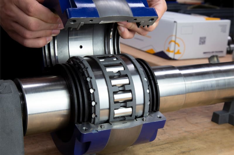

Delivering up to ten times faster bearing change times compared to solid bearings, Bowman Advanced Split Roller Bearings have been designed with speed of maintenance in mind.
“When space is limited, engineers often need to disconnect the coupling and move other equipment, such as motors, gearboxes or pumps out of the way before they can slide solid bearings off the shaft for replacement or maintenance,” explains Ian.

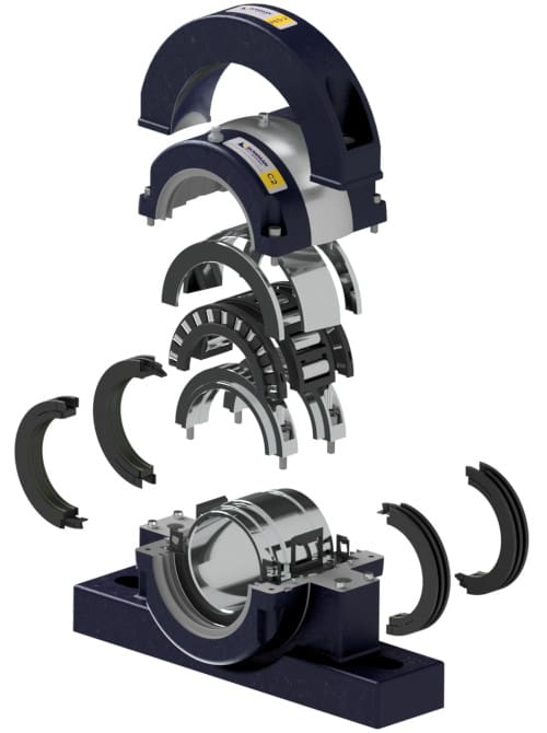

“Split roller bearings can be assembled radially around the shaft, eliminating these additional logistical challenges and making maintenance and replacement a lot faster and more cost-effective. To further enhance time and cost savings, the Bowman Advanced Split Roller Bearing uses the rollers to lock the two cage halves together, eradicating the use of small and easy to lose clips and other locking components.”

Further enhancing the performance of this revolutionary split roller bearing is a patented triple labyrinth seal which not only offers a tighter seal than other split bearings, but also reduces the need for costly removal, machining or replacement of worn shafts.
When a shaft becomes worn, engineers can simply fit a new extended seal covering the undamaged part of the shaft, without compromising performance and without the need for extended downtime.
Alongside the significant increase in radial and axial load capacity, this new bearing design offers a range of additional installation and performance benefits, such as larger diameter screw sizes to accommodate increased capabilities for the clamp rings, cartridges and pedestals and roller pockets with cavities to hold the grease against the rollers.
