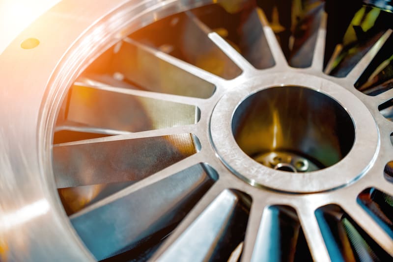

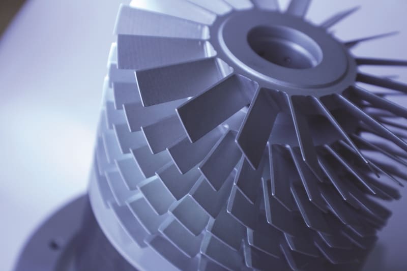

There are typically two types of pump – Fore vacuum pumps, which take the pressure from atmosphere down to 10-3 mbar and then turbomolecular pumps (TMP) typically operate at ultra high vacuum levels down to 10-9 mbar. In this latter application the bearings are often required to work at high speed. However, regardless of the pump type there are some common challenges:

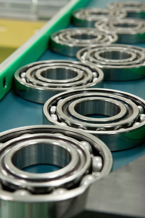

Specialist precision bearings means pumps can operate to their maximum performance levels and over many years

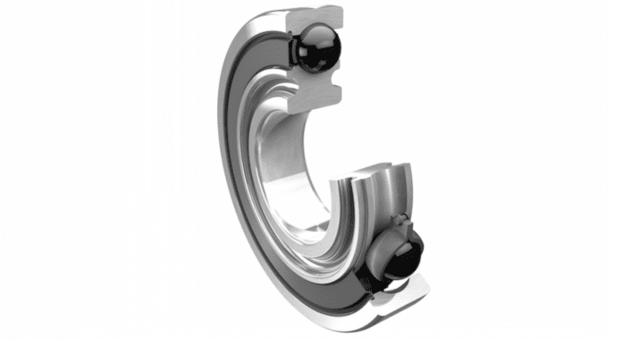

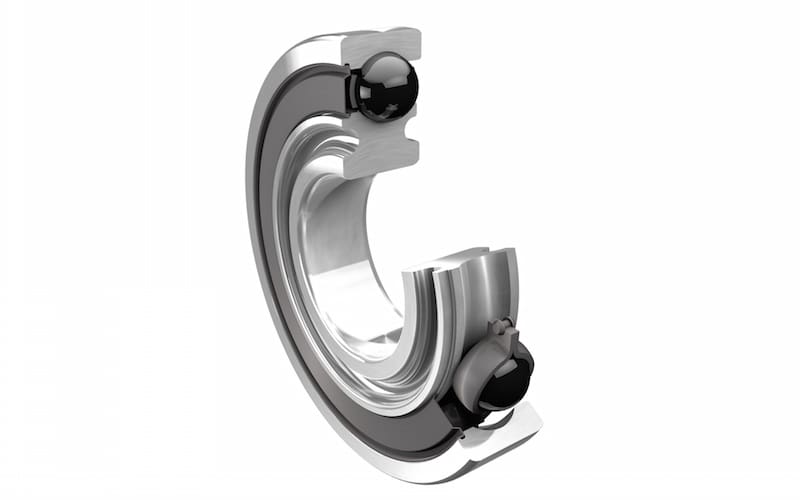

Another material that delivers superior reliable long life performance is ceramic (silicon nitride) balls, thanks to the material’s inherent mechanical properties. Use of ceramic balls in place of steel balls can radically improve bearing performance in several ways. Because ceramic balls are 60% lighter than steel balls, and because their surface finish is almost perfectly smooth, they exhibit vibration levels two to seven times lower than conventional steel ball bearings. Ceramic hybrid bearings also run at significantly lower operating temperatures, allowing running speeds to increase by as much as 40% to 50%. Lower operating temperatures help extend lubricant life. Bearings with ceramic balls have been proven to last up to five times longer than conventional steel ball bearings. Systems equipped with ceramic hybrids show higher rigidity and higher natural frequency making them less sensitive to vibration.
Precision bearings contribute to an overall reduction in the total system costs.
Bearing precision also plays a big part in efficiency and reliability and there is a direct relationship between precision class and bearing life. Bearings with the highest tolerances offer the highest precision levels and a longer life. Pump manufacturers should look out for bearings classified as at least ISO P4S (ABEC 7) as standard to ensure they deliver the best performance.
