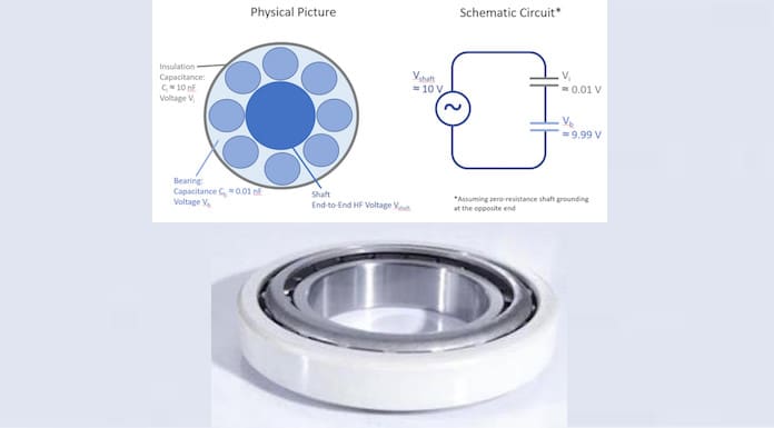

Insulated bearing, with white aluminum oxide coating on outer race
These bearings are made of steel, with a thin layer of aluminum oxide on one race (typically the outer race).  So you end up with a thin non-conductive layer between the bearing and the motor frame.  Ordinarily, that insulating layer is enough to break the circuit so circulating current can’t flow.  In order to flow at all, it must flow at both ends:  Onto the rotor at one end, and off it at the other.  Insulated bearings block that flow at one end, and that’s all it takes.

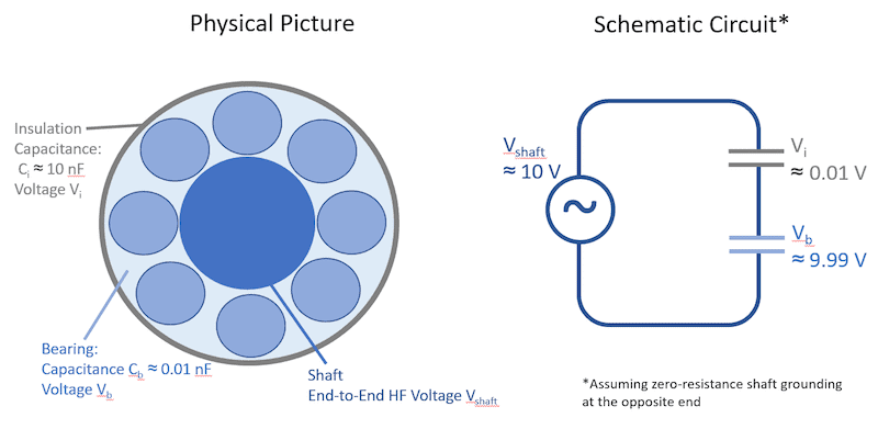

But whenever you have a thin layer of insulator between two conductors, you have a capacitor.  Together, the bearing’s outer race, alumina, and bearing housing make a capacitor.  The bearing itself also has some smaller capacitance.  Now, HF circulating current is driven by a HF end-to-end voltage on the shaft.  To that voltage, the bearing, insulation, and housing look like two capacitors in series.  Because the bearing’s capacitance is lower than the alumina’s, most of that voltage ends up across the bearing.
Model circuit of an insulated bearing. With the ballpark figures given for capacitances and shaft voltage, 99.9% of the voltage ends up across the bearing.
In the rare cases where insulated bearings fail, that voltage is enough to cause arcing through the bearing.  At the other end, current would flow in the other direction through the grounding ring (if installed) or the other bearing, to complete the circuit.  Again, this problem is rare.  99% of the time, an ordinary insulated bearing will not be damaged by circulating currents.  At least, not fast enough to cause premature failure.

You can also try an insulated inner race.  Because it’s smaller, an insulated inner race will have less capacitance than an insulated outer race.  Having less capacitance in the insulation makes for less voltage across the bearing.  So breakdown (arcing) is less likely.
