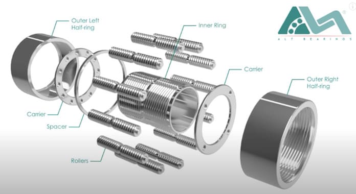

How is the Herringbone Roller Bearing HHT designed?
This video presents how the Herringbone Roller Bearing HHT is designed. Details of Inner ring, rollers and outer ring; Rollers and Rings are designed with Long Identical threads (equal pitches for right and left threads). This type could easily be installed as a drop-in replacement for any quad set of regular angular contact ball bearings 73xx series. This version is optimized for even loading conditions (push/pull)
More information can be found at the website of ALT Bearings
