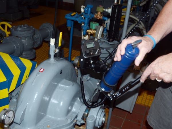

Lubrication is far more complex than just buying oil or grease and throwing it into your equipment, of course. Selecting the right type or types of lubricant, storing and filtering them correctly, monitoring bearing noise, and ensuring that over-lubrication and under-lubrication don’t occur all play an important role. Fortunately, there are more technologies than ever in the marketplace that allow you to manage your lubrication program effectively.

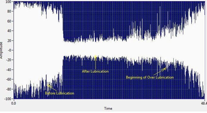

An ultrasonic instrument as the UE Systems Ultraprobe 401 Digital Grease Caddy can bring your facilities management game to the next level. The Ultraprobe 401 uses ultrasound technology to provide critical data about baseline dB levels, dB levels before and after applying grease, cost analysis of lubricants and other vital information. Over-lubrication is often a problem as big as or bigger than under-lubrication – in fact, 70 percent of lubrication professionals believe it’s a problem at their plant.
When excess grease gets into a bearing, it begins to churn and heat up. This churning causes the lubricant to solidify, blocking the entry of more, fresh grease and ultimately causing a bearing to fail. Another possible failure mode that can arise from over greasing is seal damage. Adding more than the necessary amount of lubricant to a bearing under the high psi of a grease gun can crack the seal, allowing outside pollutants to infiltrate.
The Ultraprobe Grease Caddy uses ultrasonic technology, so that lubrication technicians know when to stop adding grease, which can prolong the life of your equipment. Its digital display allows the user to gauge friction levels through the dB levels. Even in high-noise environments, the Ultraprobe 401 is able to isolate the necessary ultrasonic waves and transmit them to the user.
