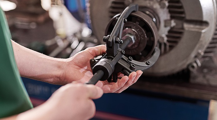

              The white paper provides guidance on how to avoid damage to bearings when mounting or dismounting.
