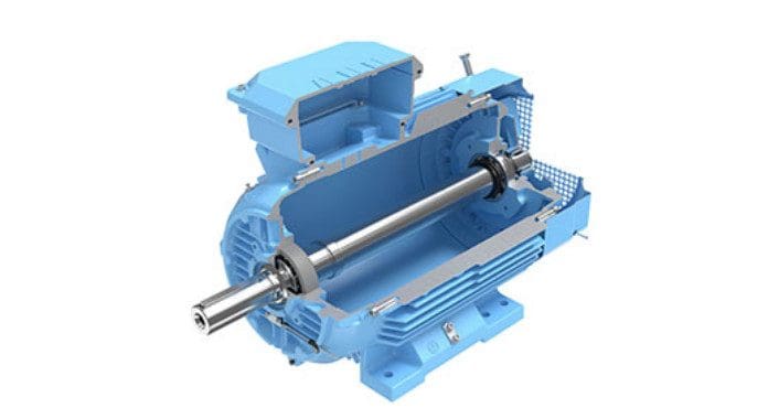

4 – Shaft grounding brush installed internally
An important new solution for motors in IEC frame sizes 132 to 250 is to install a motor shaft grounding brush that directs the current to the ground via the brush, rather than through the bearing. This protects  the motor itself and the complete installation. The brush can be pre-installed on new motors by specifying a variant code. Or it can be retro-fitted on site.

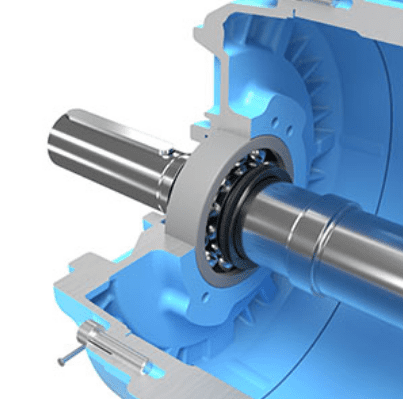

5 – Insulated bearings at both the driven and non-driven ends
Another innovative approach, now being applied to motors in IEC frame sizes 71 to 250, is in the form of bearings installed at both ends of the motor with insulated outer races or rolling elements. This ensures that no current can flow to earth via the bearings. For smaller motors, as well as for special applications, hybrid bearings with non-conductive ceramic rolling elements can also be used. These hybrid bearings can offer other benefits such as longer re-lubrication intervals and a longer service life.
