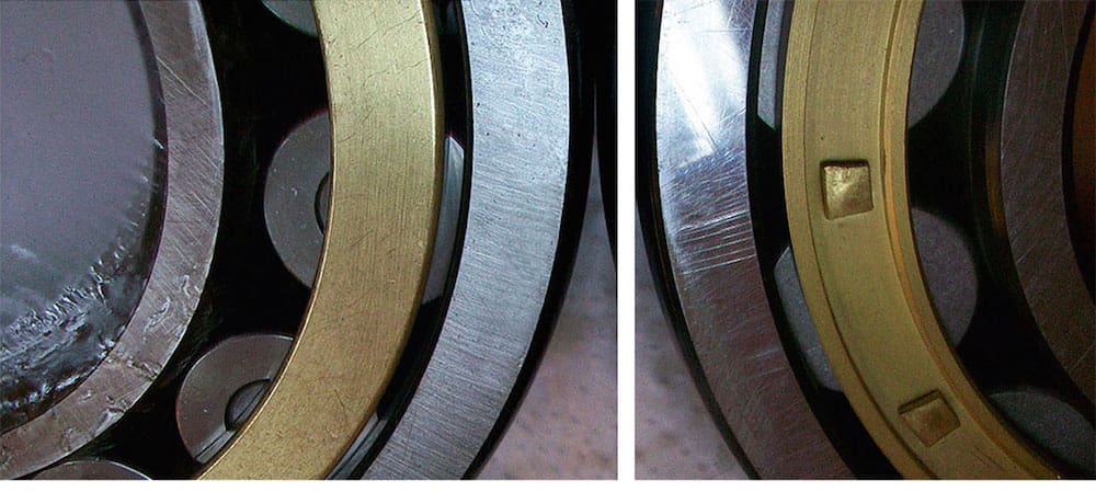

Although similar in general appearance, there are several areas in which authentic (left) and counterfeit (right) are different, including indentation on the rollers

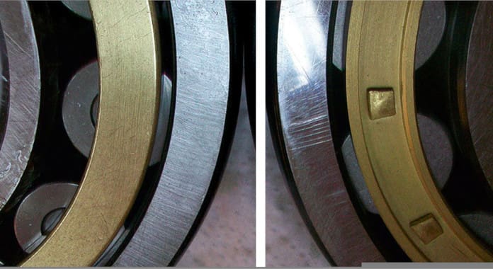

Poor quality is another factor that can help reveal fraudulent bearings. A close-up inspection of the rolling elements and raceways will provide key indicators, such as rough finishes and abnormal roller appearance. NSK’s manufacturing processes have been refined over many decades and, in combination with rigorous quality procedures, means there is zero potential for poor-quality products.
The photo on the left shows a single-piece machined brass cage with broached pocket, while the photo on the right shows a counterfeit two-piece cage with rivets. The difference in the cage could cause bearing failure
