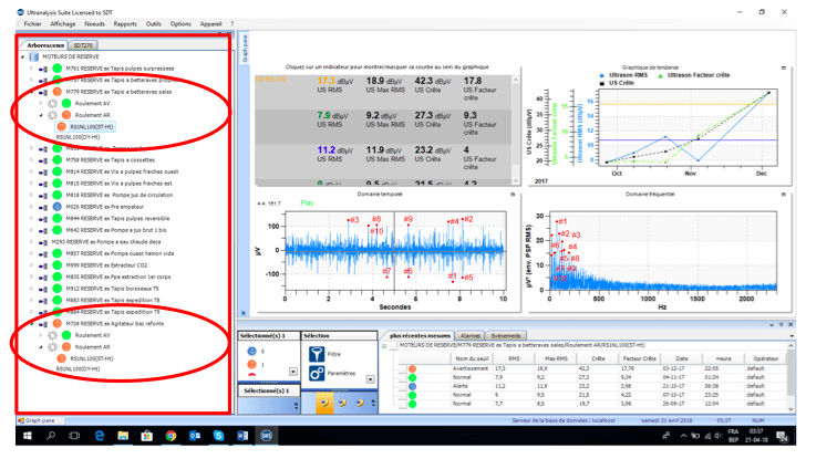

Display of the database in the UAS software
Display of the asset hierarchy including all rotating machines under monitoring and alarm statuses for each piece of equipment. In the present case, 19 rotating machines are monitored, 2 of which have exceeded the danger threshold for the bearings of the rear motor.
Display of the software graphic tools (matrix, trend curves, time signal, FFT spectrum, measurement time history)
