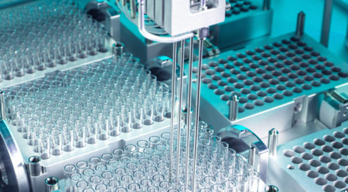

Liquid handling instruments in laboratories require precise, accurate and reliable motion. If lab lab samples are manipulated incorrectly, they will produce errors or inconsistent results during analysis. Therefore, scientists must be confident that a correct amount of liquid is dispensed every time. And, because automated liquid handling machines are required to manipulate and process high volumes of samples at high speeds, labs can’t afford downtime due to maintenance.
Recently, a major manufacturer of life sciences equipment turned to IKO when it needed a low-maintenance linear guide assembly to provide smooth, repeatable motion for a new line of air pipettes for its automated liquid handling instruments. The pipettes are designed for a redeveloped syringe pump. The syringe pumps are integrated into an automated robotic gantry system that will process arrays of fluid samples for analysis.
The syringe pump acts as a small linear motion actuator and has a built-in pump rod that can pull in and dispense a very precise volume of liquid as it slides in and out of the module. A linear rail assembly holds the pump rod in place and provides linear motion as the robotic arm moves the syringe pump fitted with a pipette array from sample to sample. An array of multiple syringe pumps can be configured within the high-speed fluid analysis systems, enabling them to process thousands of samples in a production cycle.
