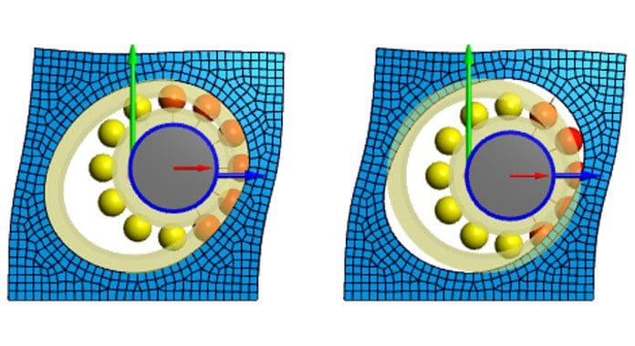

As simple example first a deep groove ball bearing in a rectangular block, which is fixed at the bottom side. The bearing is loaded horizontally.
On the left the deformations and the load distribution with consideration of elastic deformations of the bearing ring, on the right one the averaged deformation of the housing is considered with a circular bearing ring:
The maximum contact stress is 3285MPa with elastic ring and 3175MPa with rigid ring. The horizontal displacement is 0.052mm with elastic ring and 0.051mm with rigid ring. The vertical displacement is 0.01mm with elastic ring and zero with rigid ring. The vertical uplift is only visible using the elastic model. As comparison the horizontal displacement without housing stiffness, which would be 0.032mm.
While the contact stress is independent on the load direction using the rigid ring, there is a dependency of contact stress from load direction using the elastic ring:
With a force angle of 0° (force to the top) the lowest contact stress results, while the maximum stress results at about 110° load direction. The overlaid variations in the curve have their reason the fixed positions of the rolling elements in the calculation.
For this example, a bearing clearance of zero was considered. Using a larger clearance would lead to higher contact stress for the cylindrical ring.
