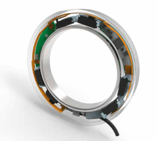

Schaeffler integrates sensor technology into its spindle bearings

When digitalized machines and equipment are designed, the rolling bearing generally represents an ideal “measuring point” for recording operating loads, process parameters, and the condition of machines. These variables occur directly in the bearing in most machines. It therefore makes sense to develop sensor systems for determining operating loads mainly in the rolling bearing. A very compact design can be achieved by clustering several sensor elements in a single, compact sensor unit. Schaeffler has implemented this approach in its VarioSense sensor bearings.
The sensor unit can be flexibly configured with various measured variables such as speed including rotation direction detection, shaft position, bearing temperature, vibration, and the resulting radial shaft displacement. The radial shaft displacement is determined with micrometer precision and correlated with the internal forces and torque in many machines. These measured variables enable the intelligent, i.e., data map-oriented operation of machines and equipment, for example. The bearing load and thus the machine load can also be determined from the displacement measurement using the bearing model. This opens up entirely new possibilities in the fields of machine control and condition and process monitoring.
Customers are already using our service range comprising condition monitoring products, smart rotary and linear products, digital services, sector-specific solution packages, and new, data-based business models in different project stages. In the next stage, Schaeffler will use this experience to further develop its range of platform-based services and thus respond to customer requirements in a quick and flexible manner.
The FAG VarioSense is a rolling bearing system that is based on standard products and can be configured in a modular fashion using a range of different sensors, which allows virtually every desired bearing position to be equipped with sensors. Schaeffler is thus paving the way towards a future in which even simple assemblies and machines will have access to digitalization and the Internet of Things.

As bearings are needed nearly everywhere where motion occurs, the spread of applications would increase. One of the main challenges would be to handle the wide range of applications in an effective and competitive manner. In many applications, a bearing is the place, where all information such as speed, load, and temperature of a device is available and therefore the additional purpose of bearings is to act as an information generator. The future bearing is more than just a bearing; it would become an integrated sensor. Therefore, the importance of bearings would increase in the future with digitalization and industry 4.0.
One example of a bearing as information generator is the Schaeffler SpindleSense, which is a very compact solution from Schaeffler for main spindles. It integrates the sensor technology, the evaluation unit for determining the measured values and the overload message output into a single unit.
