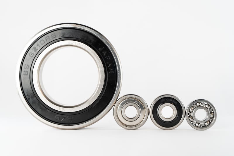

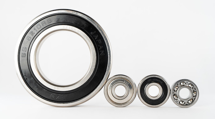

Not all bearing steels are equal
Various materials have been used by the bearing industry, undergoing different heat treatment and processes to attain the desired properties to maximise bearing life and performance. Chrome steel is the most common material for ball bearings due to its high load capacity and good low noise properties. 440 grade stainless steel bearings, are sometimes used in marine environments and are an obvious choice for corrosion resistance. However, they do have a limited resistance to seawater or salt spray. 316 grade stainless steel bearings are often specified for more aggressive environments provided loads and speeds are low. Full ceramic bearings are a popular choice for higher load applications.
A more recent alternative is high nitrogen stainless steel. This ultra clean steel with a fine and uniform microstructure has very high corrosion resistance, high wear resistance, high rolling contact fatigue strength and high impact toughness. High nitrogen steel bearings are supplied with ceramic balls to provide marine grade stainless steel bearings for higher loads and speeds than even 440 grade stainless steel can achieve.

Seals
In harsh environments, contamination protection is of utmost importance, so opting for a contact seal is favourable to ensure contaminants do not enter the steel bearing. For equipment that may be exposed to moisture, a contact seal will also offer increased water resistance. This will stop grease washing out of the bearing, allowing it to do its job in lubricating and protecting the internal surfaces of the bearing. An alternative option is a metal shield but this offers greatly reduced protection against moisture.
