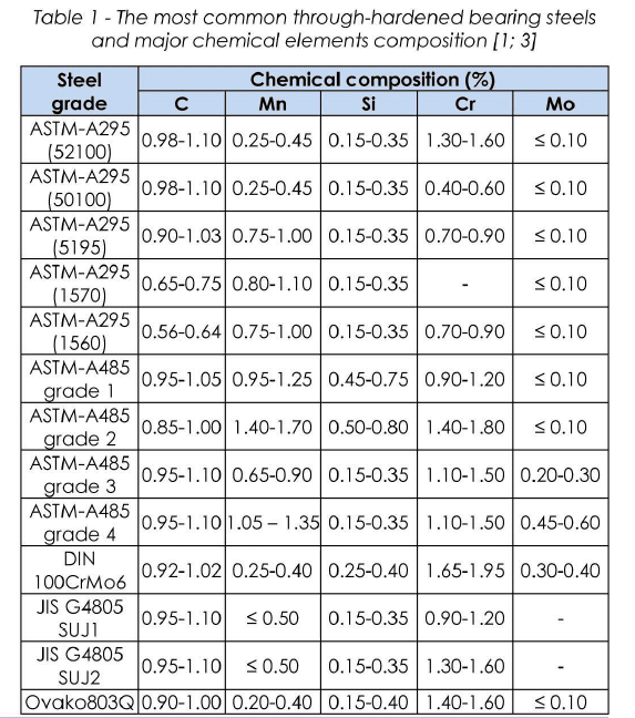

There are two major rolling bearing steel variants [2]:
– the through-hardened steels (table 1), for which, after the final heat treatment, the hardness attains the high value of 58-64 HRC in the entire volume if the bearing components;
– the case-hardened steels (table 2),for which a carburizing treatment increases the carbon content up to 0.65-1.10 % only in a superficial layer of 0.7-3.5 mm thickness, where a proper hardening and tempering treatment ensures the needed high hardness of 58-64 HRC,while maintains the rest of the material at a much lower hardness 0f 32-48 HRC that provides a better operating toughness.

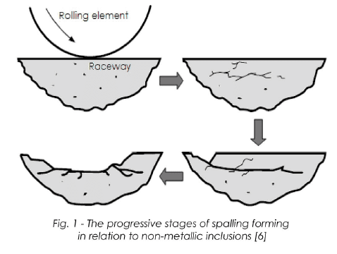

One major factor that determines the rolling bearing fatigue life is the homogeneity and purity or cleanliness of the steel. A given steel can be considered clean if its content of impurities, such as phosphorous, sulphur, silicon and aluminum, is very low. These impurities in combination with oxygen form non-metallic inclusions [4].
If two groups of identical rolling bearings were manufactured using the same type of materials, but from different lots, which means possible different contents of non-metallic inclusions, a considerable difference in the distribution of the actual fatigue lives might be expected [5]. The existing non-metallic inclusions act as stress risers able to initiate micro-cracks during the repeated contact stresses introduced by the rolling load in the shallow layer of the raceways. Eventually these micro-cracks can break through the raceway surface and in time spalling may occur and lead to total bearing failure (figure 1) [6].

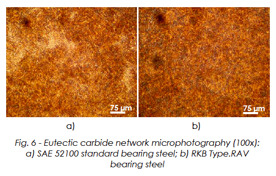

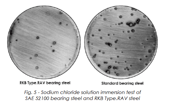

The high corrosion resistance of the RKB Type.RAV steel was proved in a sodium chloride solution immersion test (figure 5). As it can be easily noticed, there is excessive rust on the SAE 52100 standard bearing steel surface compared with the RKB Type.RAV steel sample. In fact, standard bearing steel contains coarse eutectic carbides that act as crack initiators and reduce chromium content in the martensitic matrix (figure 6a).
Conversely, the RKB Type.RAV steel has no eutectic carbides but consists of fine dispersed carbides and strong martensite that improve resistance to corrosion (figure 6b).

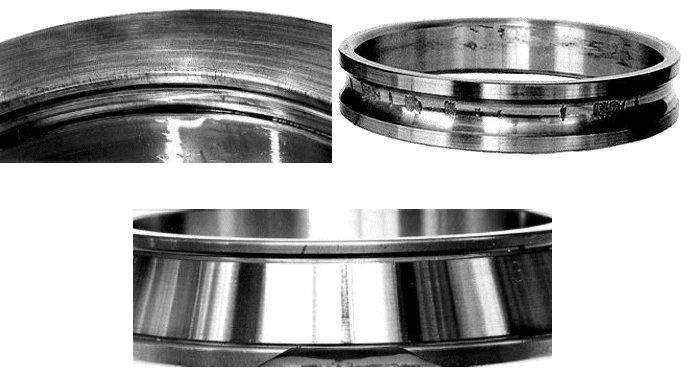

As common knowledge, an improper mounting process can damage the rolling bearing (figure 7) [8]. Due to the more stable structure of the RKB Type.RAV steel, the possible overheat generated during an improper mounting operation does not affect the involved bearing elements.

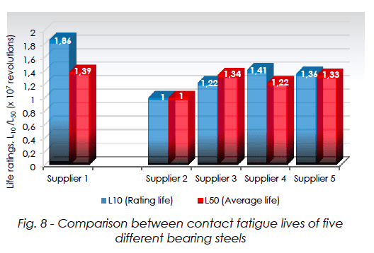

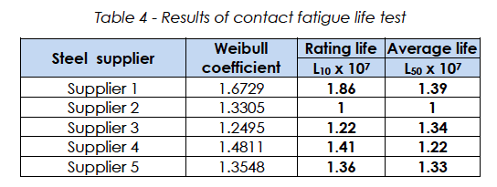

A contact fatigue life test was performed to check the quality of the bearing steel used by RKB in comparison with the steels provided by different producers. Five leading steel suppliers were selected and to one of them we imposed to respect the RKB JX80X Series bearing steel protocol for premium reliability in critical applications. The material test specimens were annealed and manufactured as washers, hardened in a gas protected electro furnace between 835 and 845 °C and finally tempered between 150 and 160 °C for 3 hours.
The evaluation was performed in a Test Life Prediction tester with a maximum contact stress of 4508 MPa and 2040 rpm. Each of the five testing groups contained a number of 16 test specimens. For each group, the tests were conducted up to the fatigue failure of all the specimens of the group.
The RKB Type.RAV premium class bearing steel, in compliance with our high quality standards, proved to be superior to the other materials.
The statistical values listed in table 4 and depicted in figure 8 point out that the test specimens made of our steel have the highest values for both rating and average life.

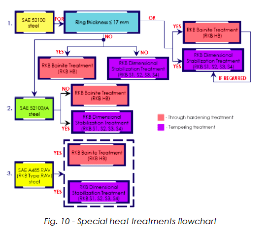

The flowchart of the mentioned heat treatments is depicted in figure 10.
The RKB Bainite Treatment can be applied to bearing rings made of SAE 52100 steel, if they don’t exceed 17 mm thickness. RKB can apply HB treatment to inner ring (RKB HB3), outer ring (RKB HB 2) or both rings (RKB HB1).
The RKB HB3 or RKB HB2 heat treatments are carried out when the technical application requires a mounting process with high interference fit between the inner/outer ring and the shaft/housing. These heat treatments significantly reduce the internal stresses generated by the previous thermal cycles, that, in conjunction with an excessive interference fit, might cause inner/outer ring to crack.
The RKB HB1 heat treatment is selected when the technical application needs a simultaneously high interference fit between the inner ring and the shaft and the outer ring and the housing. By reducing the stress level the cracking incidence is reduced in both rings and a longer fatigue life is attained.
In addition, if the thickness of rings does not exceed 17 mm, also the RKB Dimensional Stabilization Treatment can be applied to both bearing rings made of SAE 52100 steel. RKB has the ability to conduct the Dimensional Stabilization Treatment for operating temperatures up to
350 °C, corresponding to RKB S4. However, the higher the dimensional stability, the lower the hardness, with negative consequences on bearing service life.
For ring thickness above 17 mm, the RKB Dimensional Stabilization Treatment cannot be properly applied to the entire material volume, while the RKB Bainite Treatment can be correctly performed.
Moreover, if rings are thicker than 17 mm, SAE 52100/A steel can be used for RKB bearings. In this case, the RKB Bainite Treatments cannot be applied to the bearing rings, due to the high content of silicon and manganese, that would increase the hardness and reduce the toughness outside the acceptable limits. By contrast, all RKB Dimensional Stabilization Treatments can be accurately applied to the bearing rings made of SAE 52100/A.
For critical/severe applications, the RKB Group uses SAE A485.RAV or RKB Type.RAV steel with both special heat treatments, independently of ring thickness.

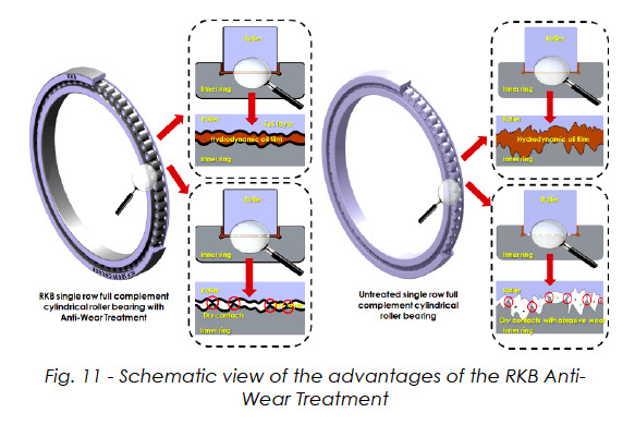

The RKB Group uses the Anti-Wear treatment to reduce both the friction and wear of the contacting surfaces that operate in mixed or even boundary lubrication regimes. The Anti-Wear treatment diminishes the risk of premature bearing failure and extends bearing service life.
The iron sulfide layer with a thickness of 3-6 µm, due to the Anti-Wear treatment, is as a porous and loose substance that absorbs more lubricating oil. It ensures the presence of a lubricating film between rolling elements and raceways, thereby diminishing both friction and wear of the contacting surfaces (figure 11). As a consequence of excessive loads or high accelerations and decelerations, the elasto- hydrodynamic film can be broken but, thanks to the self- lubricating layer of iron sulfide, the bearings with the RKB Anti-Wear Treatment can correctly function in the boundary lubrication mode without any abrasive wear.
On the contrary, in case of bearings without anti-wear treatment, the boundary lubrication regime implies an increased friction and, even more important thing, an intensive abrasive wear able to speed up the bearing failure.

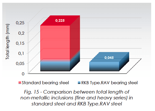

In order to make clear the differences between standard bearing steel and RKB Type.RAV special bearing steel, we evaluated them from a metallographic point of view. We investigated an area of approximately 112 mm2 for non-metallic inclusions according to ASTM E3 and ASTM E45
Figure 14 shows that the number of sulphides, silicates, globular oxides and alumina oxides, in fine and heavy series, is much higher in standard bearing steel than in RKB special bearing steel. The evaluation of the total length of non-metallic inclusions consisted in a longitudinal (parallel with the material flow lines) section inspection. As figure 15 points out the total length turns out to be much higher in standard steel than in RKB Type.RAV steel.
