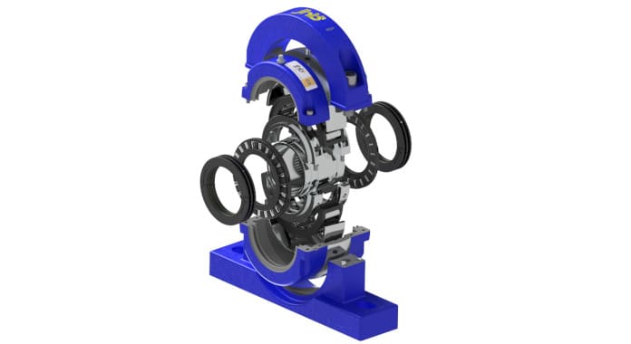

Much has already been written about the new JHB Split Bearing online and in the industry press. It is being positioned as “a revolution in design” and for good reason as the design of the split bearing has not really changed since its invention in 1907. JHB and Bowman have redesigned the entire bearing around the radial and axial bearing cages unlocking previously impossible capacities. These new capacities allow JHB to replace the four separate series of existing split bearings with just one single series.
Redesigning the cage
Perhaps the most notable part of the JHB Split Bearing is the patent-pending Rollertrain cages which were recently “Highly Commended” at the prestigious TCT Innovation Awards. JHB & Bowman have developed a design that allows much closer spacing of the cylindrical rollers compared to traditional designs and in so doing increased the radial capacity by 70% and the axial capacity by an astounding 1000% – significantly higher than any other split bearing in the world.
These incredible numbers are achieved through the fact that the radial and bi-directional axial loads are, for the very first time, handled independently. The loads are accommodated by three independent sets of rolling elements to handle three load directions. This opens up a brand new dimension which makes the JHB Split Bearing the first ever split bearing to allow calculation of an axial L-10 life.
It is the use of a bi-directional axial cage that really makes the JHB Split Bearing a true innovation. By inserting an axial bearing either side of the free bearing it converts it into a fixed bearing which allows the axial capacity to be increased by ten times that of any existing split bearing and the calculation of the L-10 life. This enables a whole new dimension of design freedom for engineers that just was not possible until now. The potential in regards to design and flexibility that this new capacity offers is quite frankly mind-boggling.

Radial capacity – 70% higher than any other split bearing
Axial capacity – 1000% higher than any other split bearing
One series
The JHB Split Bearing is manufactured in just one series, meaning that its capabilities can replace all four series of existing split bearings
Conversion
The JHB Split Bearing is dimensionally compatible with existing split bearing Pedastals to accommodate ease of conversion.
