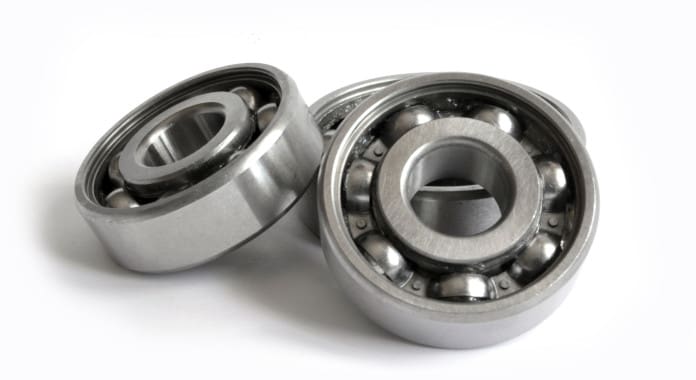

A lubricant provides a thin film between the contact areas in a bearing to reduce friction, dissipate heat and inhibit corrosion on the balls and raceways. This is hardly a new concept, but exciting innovations in food-grade lubricants are helping facilities to enhance their production efficiency and extend their equipment service life, while reducing the risk of lubricant contamination to food and beverage products.
Food-grade lubricants are effective under severe food processing operating conditions, such as exposure to high-pressure water jets, caustic and acidic chemicals, chlorine-based sanitisers and extreme temperatures. This means that lubricants must be resistant to wash-out and spray-out if they are to protect machinery from wear, rust and corrosion.
Ball bearings are traditionally lubricated with grease and oils, but this requires maintenance, leading to additional costs. Another potential issue is over-lubrication, which can result in bearing lubrication leaking out and contamination occurring. So, what is the alternative?
Polymer solid lubrication
An alternative option to greases and oils is polymer solid lube (PSL), which is gaining traction with food and beverage facility managers. PSL is a microporous polymer structure loaded with oil that fills the free volume in the bearing between the races, rolling elements, and cage. During bearing rotation, the solid polymer releases the appropriate amount of oil to lubricate the rolling elements and raceways.
Solid lubricants tackle various problematic scenarios in food processing, reducing the risk of leakage, reducing costs associated with relubrication and downtime caused by cleaning or bearing failure. What’s more, there are various PSL grades available to suit specific conditions such as extreme temperatures or extreme chemical resistance.
For example, all-purpose food grade PSL have an operating range from -45°C to 93°C. In mechanical freezer applications, where low temperature operating conditions are required, PSL is an effective choice to minimise maintenance. In addition, solid lubricants can act as an additional barrier to protect against larger particles entering the bearing, extending bearing service life.
