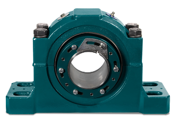

- Solution: Safety Mount™ mounted spherical roller bearings

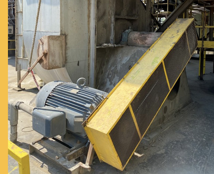

One of their lumber mills in Warren, Arkansas processes 220 million board feet per year of southern yellow pine. Once received at the mill, logs are debarked, cut to length, cut down to boards, edged, trimmed, sorted, and stacked in preparation for the dry kiln process. The dry kiln process, essential to wood production, dries the wood boards by circulating hot air through a chamber via large forced draft fans.

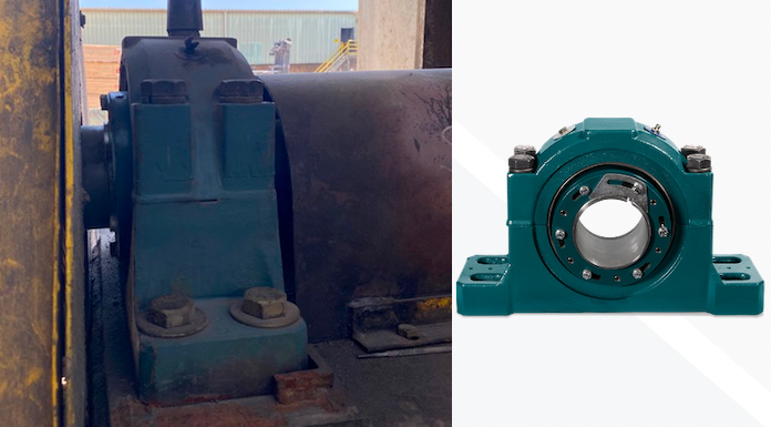

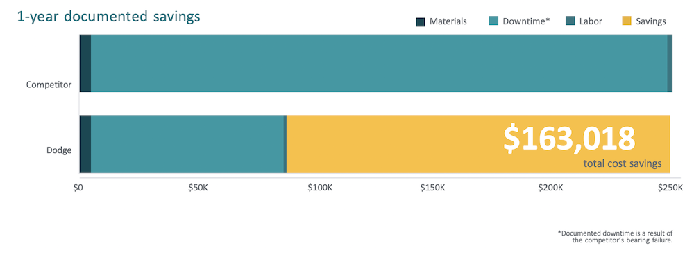

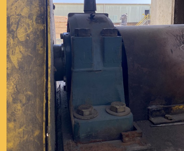

The fans used a competitor’s 4-15/16 inch SAF-style bearings, requiring two skilled maintenance workers, six hours of labor, and exact measurements using specialty tools for installation. In this harsh application, unplanned downtime due to bearing failure was occurring once per year and cost the manufacturer $40,800 per hour in production value.

Due to continued failures, lengthy installations, and critical uptime requirements in the mill, plant management tested two Safety Mount bearings on one of the fans in their drying kiln.
The results

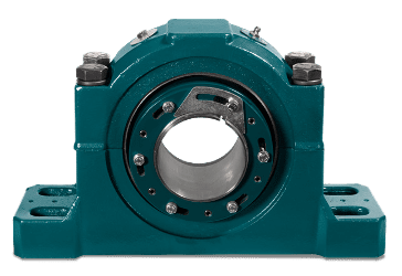

As a drop-in replacement to the existing bearing, Safety Mount’s seamless installation of two hours versus the competitor’s six hours of downtime immediately impressed plant management. Without factoring in the increased reliability of the prelubricated Dodge® product, the valuable time savings for increased uptime and the impact on future productivity led them to standardize the mill on Safety Mount.
The why
Shaft-ready out of the box, Safety Mount is a drop-in replacement for SAF-style bearings and features an innovative design with unparalleled advantages over the competition. Its patented dual lock nut eliminates the need for feeler gauges, subjective measurements, and manual calculations, resulting in immediate time savings and improving operational reliability. The patented lock plate utilizes a single-bolt securement mechanism for 360-degree placement options with no hammering for a faster and safer installation. Built to revolutionize mounted spherical roller bearing installations, Safety Mount is the premier problem solver for critical applications.
