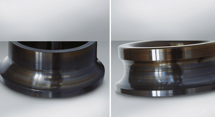

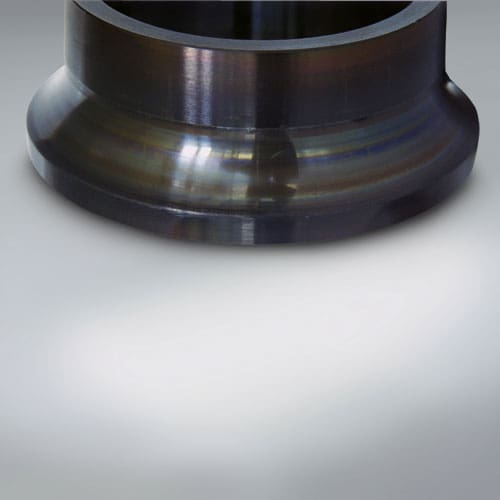

Discoloration 1
Part: Inner ring of an angular contact ball bearing
Symptom: Bluish or purplish Discoloration on raceway surface
Cause: Heat generation due to poor lubrication

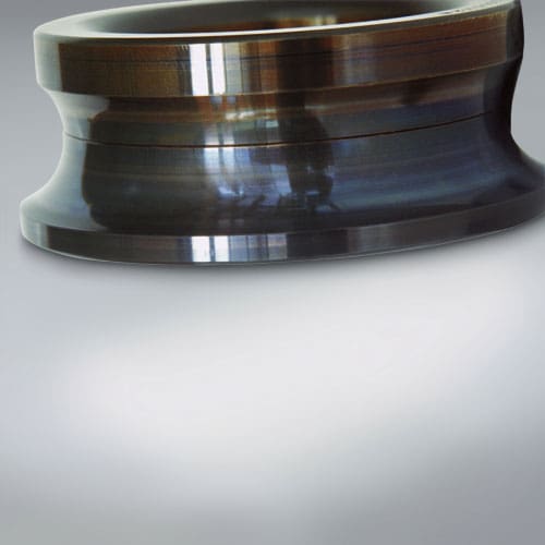

Discoloration 2
Part: Inner ring of a 4-point contact ball bearing
