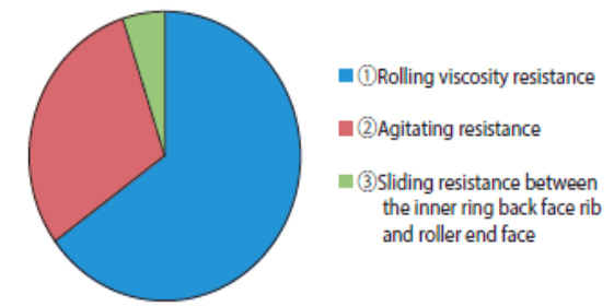

The conventional way to reduce the torque was to concentrate on sliding resistance and viscous rolling resistance. Later the influence of oil agitation resistance was recognized and considered for further improvement. These contributing factors to the friction torque and their relative influence are shown in Fig. 1.
Fig.1 Factor contributing to friction torque and their relative influence

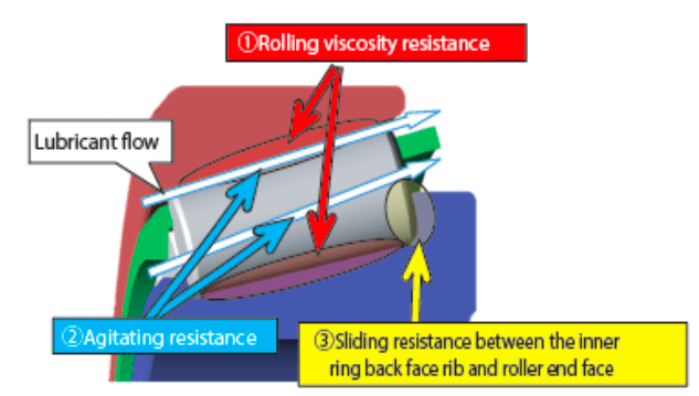

Tackling the sliding resistance factor first, Koyo engineers originally decided to optimize the profile & roughness of the large rib and roller end face, leading to the LFT I generation (Fig. 2 – no. 3).
Fig.2 Areas of internal desing improvement for LFT
A further improvement to reduce the viscous rolling resistance was realized by special “crowning” of the raceways, leading to LFT II (Fig. 2 – no. 1).
As a next step the steel cage was redesigned to better control the inflow of lubricating oil (tackling oil agitation resistance) and the internal geometry & raceways were further optimized (tackling rolling viscosity resistance), leading to LFT III in ~2006 (Fig. 2 – no. 1&2).
