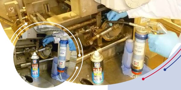

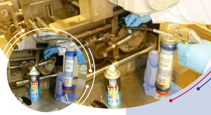

H1 Quinplex Food Machinery Lubricant (4025) was recommended due to its resistance to washdowns. This product clings tenaciously to metal, protecting bearings and other metal surfaces. It is also rated as a General Mills A Lubricant.
Results
The Quinplex grease stays in place even after the regular wash downs that occur. Lubrication intervals have increased from the previous once per day to now only once per week. Lubricant usage has reduced dramatically, and bearings are no longer failing at the plant due to inadequate lubrication.
“When we get new sealed bearings, we clean them out and repack them with Quinplex (4025), to make sure they will last”, said Bill Fitzgerald, Engineering Manager.
