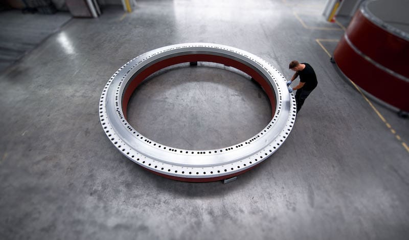

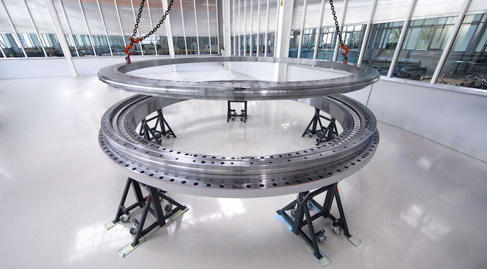

                        The assembly of the triple-row roller bearing takes place in Biberach an der Riß (Germany).
The floating structure is as reliable as its land-based counterpart: To ensure the self-alignment of these turbines, the Liebherr slewing bearings function as a mooring-system. For this purpose, a bearing with a diameter of four metres is installed as a connecting element between the anchor buoy and the float below the sea surface. Because the slewing bearing has to withstand high pressure and corrosive environmental conditions, some components are made of stainless steel or welded on with stainless steel. In addition, the bearing has two sensors that can detect the unlikely event of water ingress – for example, when seals wear out – at two measuring points. One is located in the first lower chamber – the second in the second upper chamber of the floating turbine. In this way, Liebherr’s unique smart bearing lubrication monitoring comes into play and shows, whether it is necessary to intervene. In case of maintenance or repair, the float with the turbines can be separated from the anchor buoy and towed to a harbour. Thus, by providing such a mooring system, Liebherr does not only contribute to the efficient use of wind as a resource on the high seas, but also to easy maintenance of floating wind turbines.
