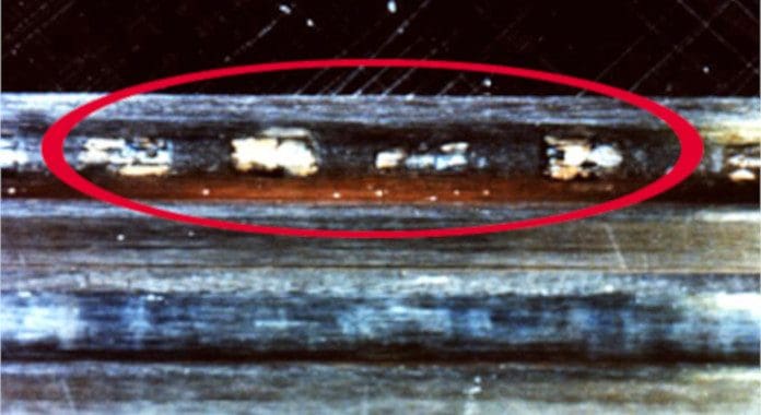

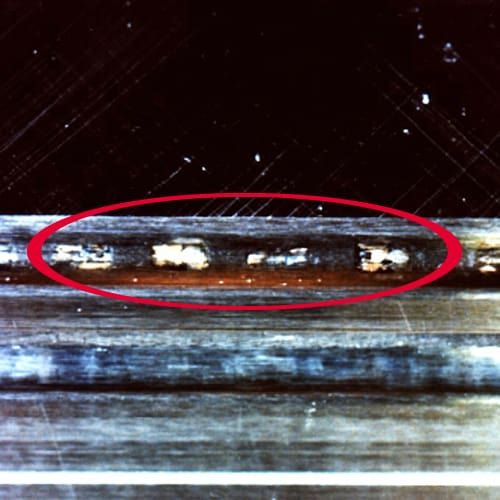

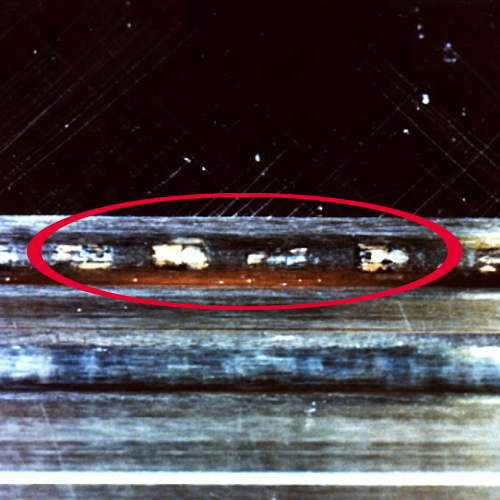

Fretting
Part: Fretting corrosions on a raceway of rail
Symptom: Completely dried out lubricant on the contacting area
Cause: Fretting caused by insufficient lubrication to the ball contact surfaces, due to relative repeated rubbing with minute amplitude motion (oscillation) between contacting surfaces
