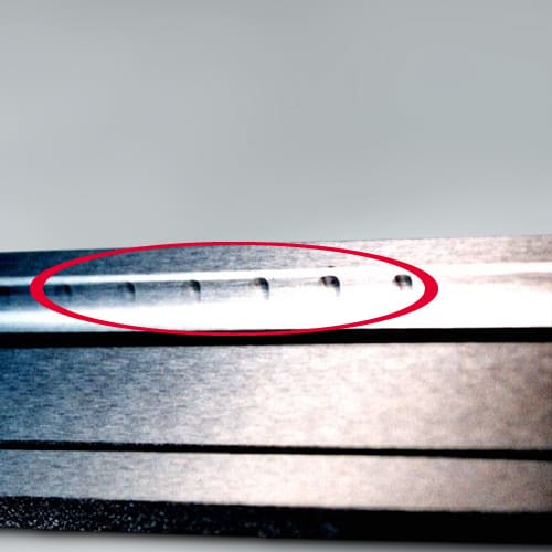

Damage Condition
- Dents on the raceway at each ball location similar to the deformation caused by a Brinell Hardness Test (Brinelling)
- Dents on the raceway caused by contamination or metallic particles
Possible Causes
- High-energy impacts or improper handling of the product at its installation or in transit will easily cause this type of damage
- Caused by contamination or intruded hard metallic particles
Countermeasures
- Adequate installation and handling
- Improve sealing capability
- Filter the lubrication oil
Indentations
Part: Brinelling on a raceway of a rail
Symptom: Dents on the raceway
Cause: The table fixed to the ball slides was lifted with the heavy machine base to which the rails were fixed, thereby causing brinellings on the raceway surfaces
Source:NSK
