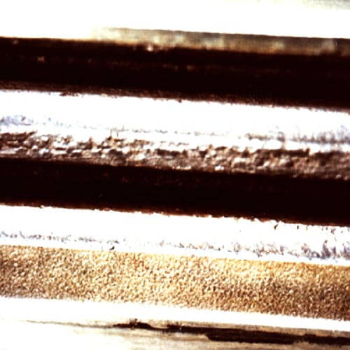

Corrosion at Ball Slider
Part: Ball slider
Symptom: Corrosion on raceways
Cause: Rusted raceways and balls caused by chlorinated cutting coolant penetrating the protective covers and attaching the ball slide
Corrosion at Balls
Part: Balls
Symptom: Corrosion on balls
Cause: Aggressive cutting coolant attacked the ball surface
