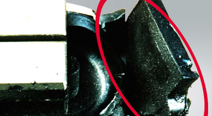

Damaged Ball Recirculation Parts
Part: End cap of Ball Slider
Symptom: Balls are free
Cause: End cap is damaged by excessive misalignment at the butting position of two rails. Ball slide operated at high speed in excess of permissible feed speed
