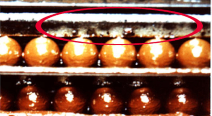

Damage Condition
Severe friction resulted in serious wear on the rolling contact surface of raceway and/or balls.
Possible Causes
  • Insufficient lubrication
  • Intrusion of foreign matter
  • Improper installation (misalignment)
Countermeasures
  • Review the lubricant and lubrication method
  • Improve the sealing capability
  • Take measures against misalignment

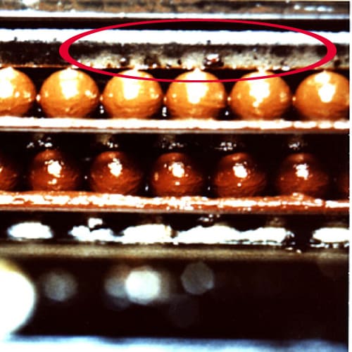

Wear
Part: Raceway of a Ball Slider
Symptom: Raceways are worn out
Cause: Insufficient lubrication that resulted from a clogged lubricant piping
Source: NSK
