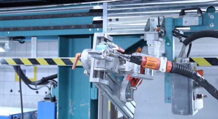

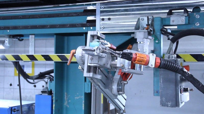

The welding system is enormous – 30 metres long and 10 metres wide. On each of the two welding machines four robots are mounted, two on the lower and two on the upper level. In a slow but constant movement, the robots weld aluminium assemblies up to 28 metres long to a wagon shell. The robots are mounted to individual rack-driven carriages, each driven by a motor, which run on two guide rails.

The rails, including carriages and bearings specified by Spie, are from HepcoMotion’s proven GV3 system. Approximately 500m of single-edge slides were used in the new design; the upper slides in each assembly were supplied with a rack to drive the carriages by motorised pinion. Double-row bearings, which are made in a single piece, were used on the carriages. “The one-piece design ensures no dirt can penetrate into the bearings. The V-guide principle also ensures that dirt particles are transferred away from the running surface as the bearings move along the slide,” explains Thorsten Pfau, Sales Manager for HepcoMotion in Germany. “These bearings have high load capacities, especially in the radial direction. In this case, this was of great importance – the mass of the welding robot and carriage is about 220kg.”
“We worked in close collaboration with the Technical Sales team in Hepco’s German office. They were extremely helpful in solving this challenge and ensuring longevity of the system can be achieved,” explains Becker. It was also important that the bearings could be manually re-adjusted, without great effort, to take away any play that develops as a result of wear from the continuous high load. HepcoMotion’s V guide systems can be quickly and easily adjusted to remove any play that has occurred thanks to the eccentric adjustment facility.
It was a lot of work for the Spie team to update the machine whilst production continued; work was carried out whenever a welding robot was not in use. “The old rails had to be disassembled and the mounting surface fully cleaned so that 5,500 new holes could be drilled for mounting the new guidance system – and all by hand! HepcoMotion’s rails are supplied in a maximum length of 4 metres, but are easily joined to make the total 30m length of the system. Alignment of each rail was of particular importance to ensure a good join between teeth in the rack and to provide a smooth movement of carriage across each joint in the slides. With the assistance of a Leica laser tracker for surveying, we were able to accurately align the rails with a deviation of less than 50 microns per slide. This means the systems are running completely trouble-free!” explains Becker proudly, who was worked with his team to overhaul the machine over a period of five months.
