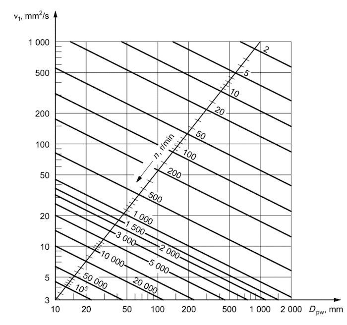

Reference Viscosity v1
The reference viscosity (or required viscosity) is a function of bearing speed n, and pitch diameter Dpw. The value that is given will be one that provides a sufficient film separation for the bearing components where calculated L10 life is unchanged. So, when the actual viscosity exceeds the reference value the life will be improved, and vice versa. ISO standard 281 provides the two methods displayed for calculating reference viscosity. Additionally, the table to the right can be used to determine v1.

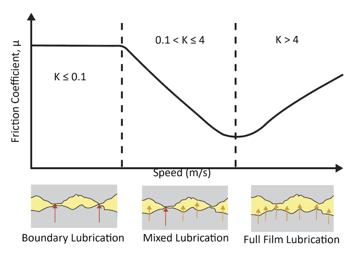

Effect on Life and Friction
When the κ is below 0.1 then full asperity contact is considered, and life is greatly reduced. And when κ is greater than 4 no asperity contact is considered, with no gain in life, and viscous friction moment will increase. If κ = 1 then it can be said that calculated L10 Life according to ISO standards is unaltered.
