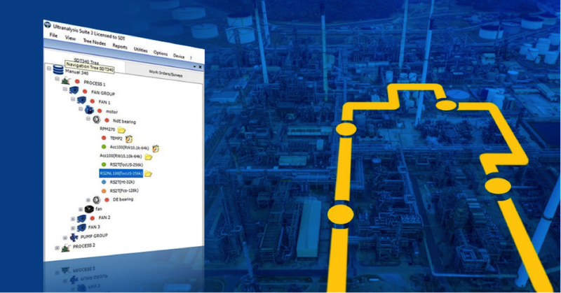

  • The right location
With potentially thousands of assets to manage, how can you be sure you’re greasing the right bearings?
LUBExpert’s onboard assistant guides you through your plant using Ultranalysis® Suite 3 (UAS3)’s tree structured navigation. With UAS3, flexibility and proper management of your asset database is achieved through hierarchical tree structure, tree structures grouped in data folders, unlimited tree structures and data folders, tasks managed through work order/surveys, predefined interval for data collection, detailed measurement point settings, detailed events log. As a result: all available information about asset itself, planned tasks, collected data and asset health indications easily accessible for each asset, assets group or plant section.

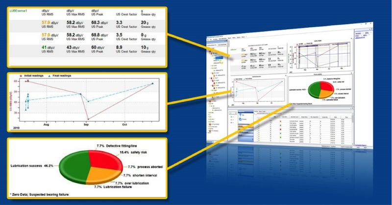

LUBExpert delivers confidence to the task of re-greasing bearings. The onboard assistant guides you smoothly through the task and concludes with the following results:
1. Lubrication success;
2. Over lubrication;
3. Shorten interval (lubrication);
4. Suspected bearing failure;
5. Lubrication failure;
6. Process aborded.
Activities are tied back into UAS3 data management software where logical reports illustrate before and after, quantity of grease added per point, and total grease consumed by department or plant.
Additionally, your UAS3 will display all events, observations and messages logged during the field work (both automatic and manually added) and during office work, such as lubrication need, alarm triggering, oil levels, operational anomalies, and maintenance activities. All this information can play critical role in analysis as each event explaining circumstances can give more meaning to any signal.
